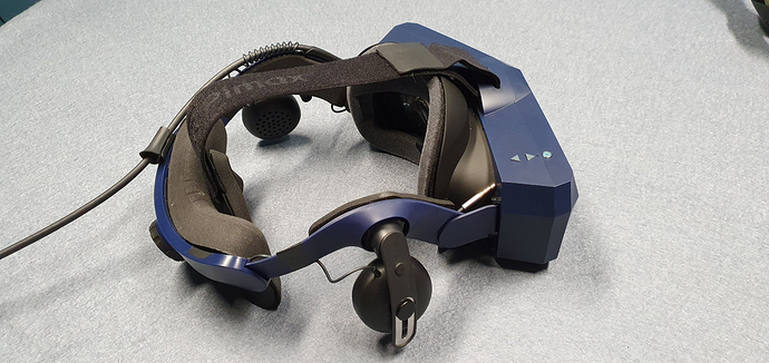

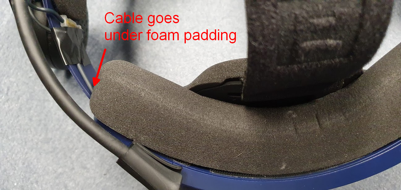

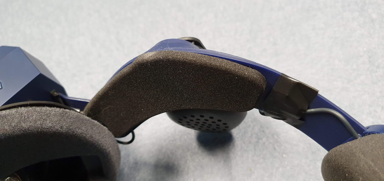

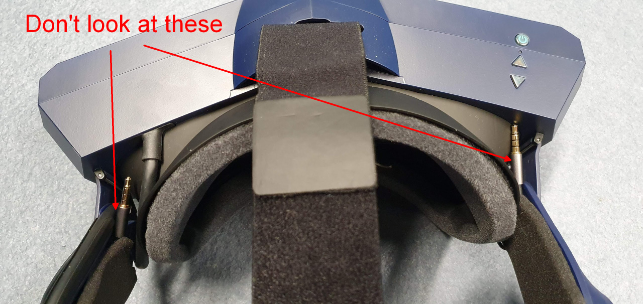

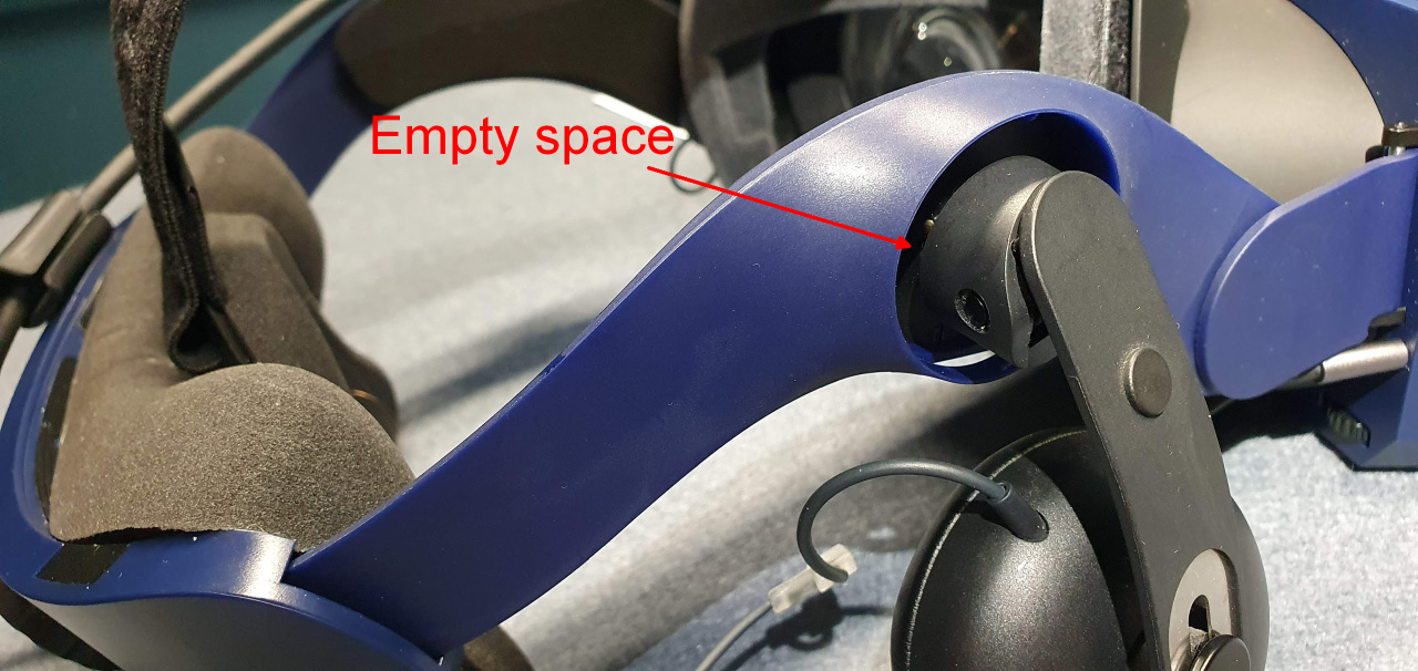

Adjusting the Standard Modular Audio Strap (SMAS) was a little ‘odd’ for me. I’ve never tried anything like this before (only ever used the cloth strap from the loan 5K+) and with no instructions, I had to figure out where the back part was supposed to be on the back of my head. At first it didn’t seem to want to go low enough and was quite high on the back, but after a bit of fiddling about I realised that the cable grip on the left side was stopping it. After feeding the cable through a bit more, the back part lowered down to a comfortable position.
