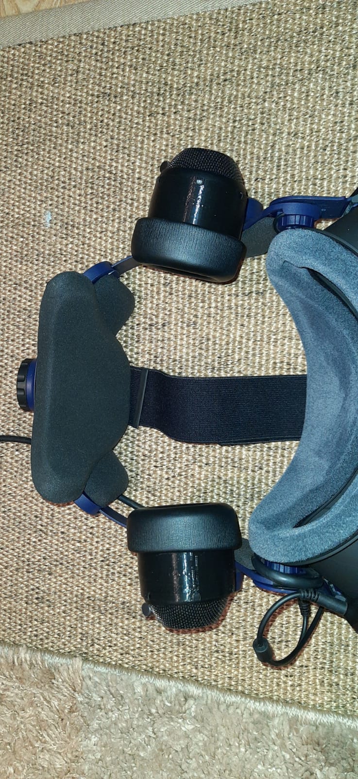

I’ve modeled up the headphone cup, with a 15mm extension, which felt about right for me at least. A friend is printing it so I’ll let you know how it goes, and share the STL if it works.

This has worked pretty well, although it’s a little harder to get on your head now as you can’t flip them outwards. The fit is a little tight too, the printer plastic doesn’t have as much give as the original.
