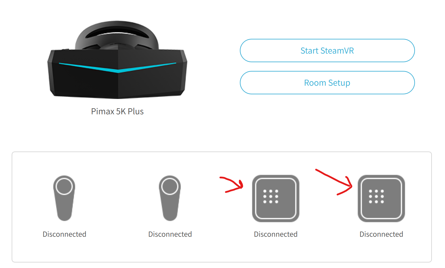

I just found out that my Pimax 5K+ is no longer tracked (haven’t used it for a week, so it was a shock to find that my controllers are far behind me in VR when they’re in my hands IRL), only the gyros are working. I set my Steam to auto update everything so steamVR got updated to the latest version.

Thanks @DrWilken, I tried that but the problem persists. Uninstalled everything and deleted all folders in local and roaming named Pimax and PiTool but after installing PiTool, the base stations are still not read by the tool.
The wands are the ones triggering the base stations to come online. So whatever Valve did to SteamVR, the latest version of it doesn’t register Pimax as HMD. So unless someone here already found a workaround to this issue, it’s back to Vive for me. Just bought Vader Immortal, can’t be arsed to wait for Pimax to come up with the fix.

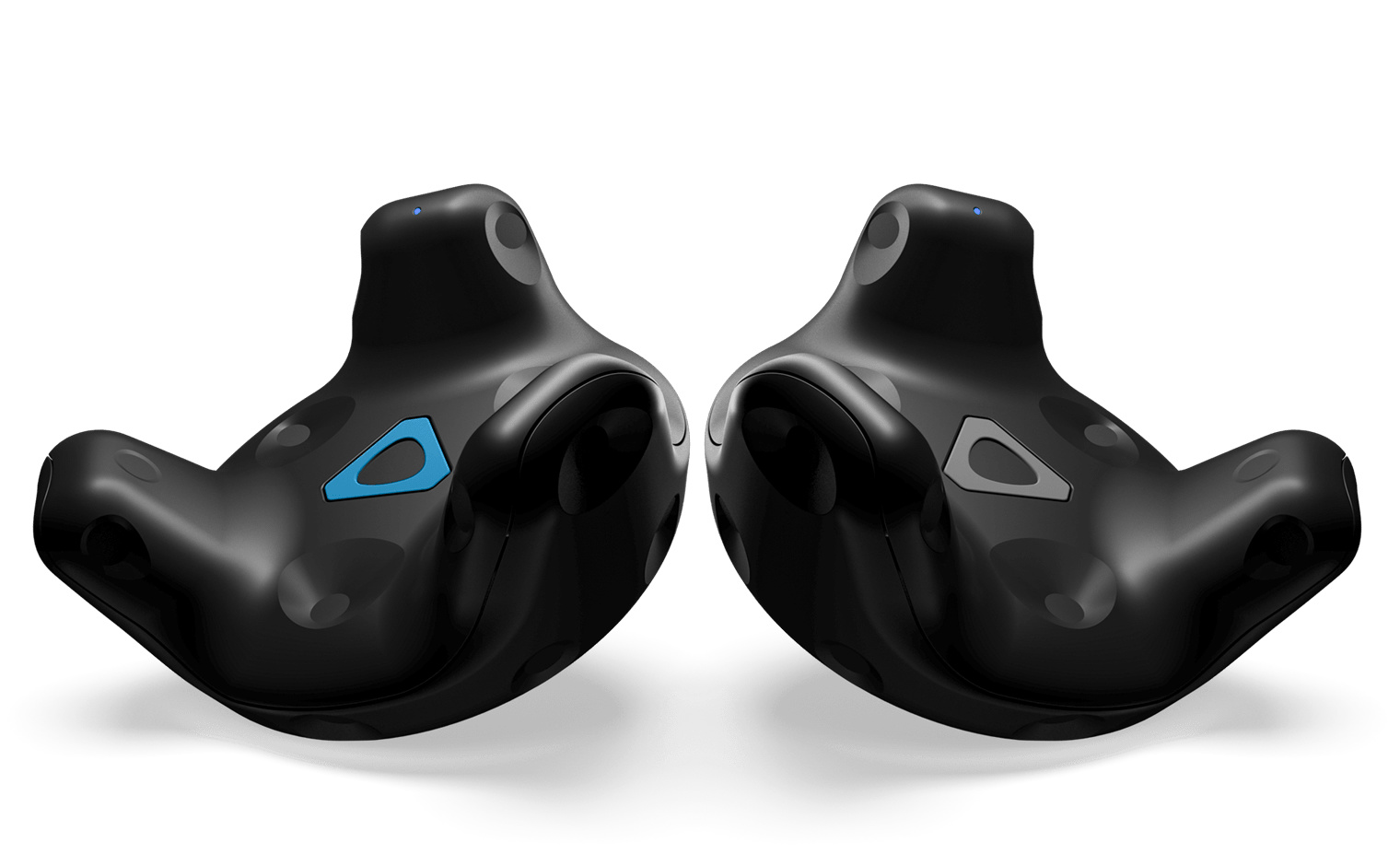

That is not what I asked. I said Vive “trackers” aka Full body trackers. Not headset, not steam controllers.

can you send me a video of what you did to get them to work please? I really need to get my Vive trackers to work again. I’m a visual learner. Again “Vive TRACKERS”, not the Base Stations, or Steam Controllers, thanks.

steamVR wouldn’t let me pair unless I have HMD, and I guess according to steamVR…Pimax is not a HMD cause it keeps saying “please make sure HMD is plugged in or wireless is connected” when I try to bind a new controller…even thot pimax is already connected
