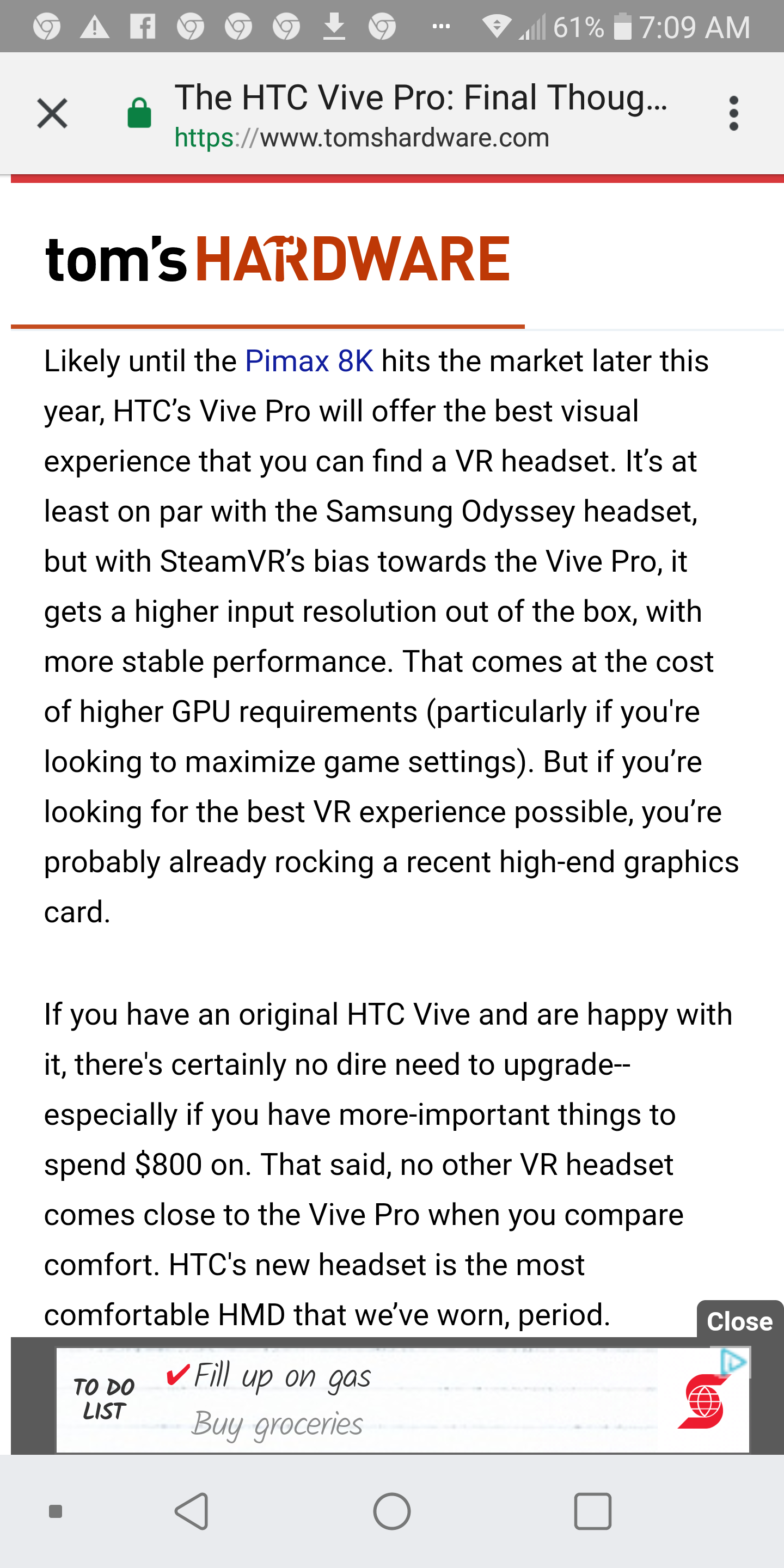

I must say I am pretty surprised about 6/10. Especially when comparing the device to the Vive Pro which is according to your review the best VR headset on the market.
Yes, it does need a fast computer, but with my 1080ti I can run all the games I want to. And for me, comparing the 5K Plus directly with the Vive Pro, the advantages of the 5K Plus are just so obvious to me.
