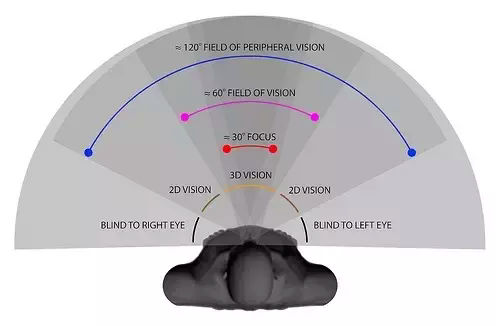

Having been a Stereoscopic gamer for over 2 decades, I have always taken for granted that humans have Stereoscopic3D vision.
Stereoscopy is [mainly] caused by FOV overlap between both eyes. However, only today I learned that the human eye is blocked by ones nose. I have measured my overlap to be approximately 90 degrees.
This means that my [and likely most people’s] stereoscopic 3D perception is limited to only 90° in front of the face.
I wonder if this is a big reason that most HMDs aim for around this figure as a minimum.

The human vision overlap for seen in 3D is about 120º.
From Stanford University.
Great article from standford. However, binocular overlap is not the only cause of 3D vision. Yes, it is the cause of stereoscopic 3d. But the way that we focus on objects in VR is completely different than on a monitor. Close one eye in VR, bring a controller up to the open eye. The background blurs. Best we could get to that in other flat games is dynamic DoF, and it’s pure cheese (though I constantly used it in ENB presets in skyrim tbh).
