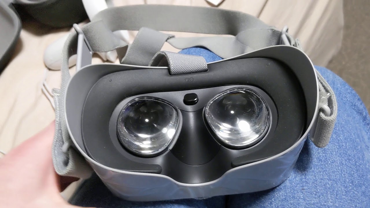

Hey this guy has problems with his lenses on quest and he does something I’ve never seen anyone do before.
He was able to show imperfections in the fresnels by shining light over them. You can see the imperefections because the rings kind of break.
I wonder if anyone has done this with the Pimax lenses.
I’m picking up the Quest 2 tomorrow. I hope mine doesn’t have this issue.
The one I had to try out was fine.
looks like it could be the vapors that come of the glue.
