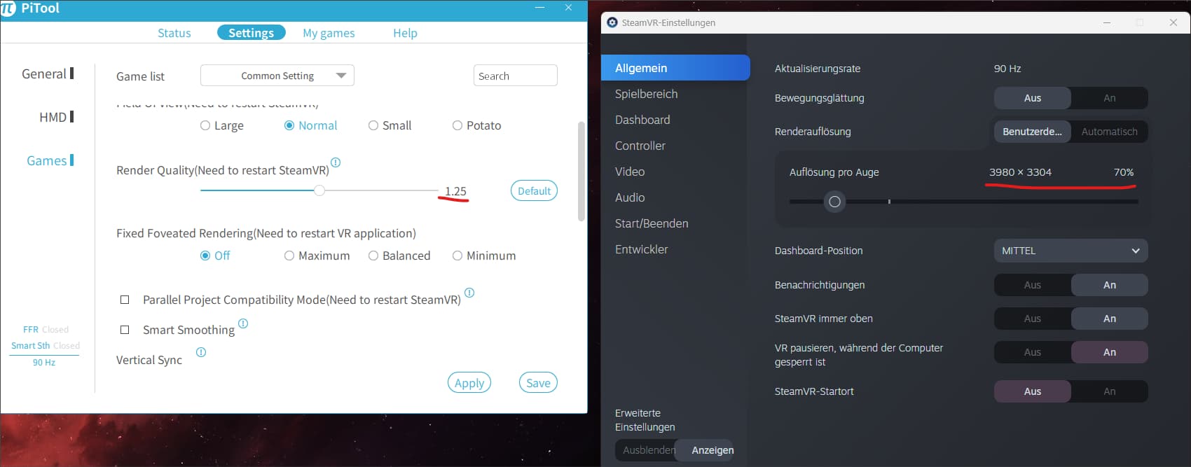

I just recognized, that the resolution which is shown in steamvr is set to 3804x3160. I havent changed anything in the Pitool. Field of View is set to normal, render quality is 1.0. Parallel Projection, smart smoothing, hidden area are all off.
Resolution is at 100% in steamvr but why 3804x3160 and not the native resolution 3840x2160?
The resolution at 100% has always been higher than native because the correction profiles are taken into account. Native would have to be somewhere around 70%. (I only use Pitool 1.25 myself, there it’s natively around 35-40% Steam SS.
I dont know, I am pretty sure that the resolution was always native when I had the same settings in Pitool. With FOV set to normal and render quality at 1.0 I always had the native resolution set in steamvr.
I am 100% sure, because I used fpsVR and optimized the s**t out of ACC to run as nice as possible with my 4090.
can not much say about FPS VR. Maybe it shows the HMD panel data. In normal FOV, the value would be completely wrong anyway, since the panel is not used in its full width. (even including the masked area) Geometrically, VR images have nothing in common with flat
It’s hard for me to tell it in English. Google about VR rendering + barrel correction etc. You will surely find pictures where there is a massive bulge. This has to be factored out again so that it looks natural to the eye.

For Parallel Projections on it is 3980 vertical.
For PP off it is 3160 vertical.
Horizontal resolutions are a factor of the FOV
For PP OFF
Small
3158 x 3160
Normal
3834 x 3160
Large
5112 x 3160
FOR PP ON
Small
3264 x 3948
Normal
4456x x 3948
Large
7716 x 3948
Note these provide the same PPD and are determined to be an approximation of the resolution that would produce a native density across the very center of the display based on the distortion profile; thus providing you the best clarity the display can provide natively…
After much digging for an answer to “Where does the 3160 come from exactly”? To my surprise: it should initially come from simply the square root of 2 times the display resolution (2160), which actually comes in at 3055 vertical for the PP off mode. To the contrary of what I first thought, it is not to produce a 1:1 pixel density “in spite of barrel distortion”, but rather to ensure there is 1 pixel per pixel at the most extreme angle (45 degrees) of the display grid vs. rendered grid. That’s where the square root of two comes from. Believe it or not: barrel distortion has no effect at the super-center of your display in non-PP mode. The 1.41 factor also provides a larger area that is at or above the resolution needed for that 1:1 pixel across a larger cone of the display, so it has TWO improvements there.
