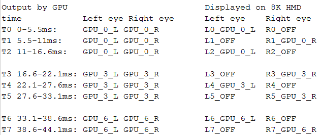

Brainwarp theory:
Input(60FPS/Hz), simulated 90Hz/eye, “180Hz Brainwarp”
1/60 16.6ms, 1/90 11ms, 1/180 5.5ms
We assume GPU has ready frame at T0 0ms after at T3 16.6ms(60FPS), and is shown on L0 panel
L0 left panel at T0 time, R0 right at T0, L0_GPU_0 - shown frame from GPU time 0(game world time)
GPU_0_L - game data from T0 for Left eye
R0_OFF - backlight is turned off during T0 interval on R-panel.
Why do you insist on limiting the input to 60Hz? Even in the videos Pimax was showing during KS campaign they were having the renderer running at 75 or 80Hz?
The idea of the brainwarp is simply interleaving the images, it does not force any particular refresh rate on the input. The limitations in the current implementation are more related to hardware components (DP chips, scalers, panels, etc.).
In your theory, you limit artificially the input to 60Hz and then come up with an idea how to display this 60Hz content on 180Hz display with complex interleaving and brightness variations which have no benefit.
Do you realize that displaying one frame twice (e.g. GPU_0_L in timeslots T0-T2) will give it two times more perceptible brightness than the following frame GPU_3_L in timeslots T3-T5.
Why would anyone do that, if he could simply display 60Hz content at 60Hz refresh and stress the display much less? (Running the display at 180Hz is definitely more challenging than running it at 60Hz)
Because they run with 80Hz input without Brainwarp on, you don’t need per eye refresh(“simulated 90” “per eye 90” “async 90” call like like you want) when you have low enough MTP with just showing whole image to both eyes at 80Hz/HMD. My theory for what means that Brainwarp as claimed “reduces perceived MTP, lowers the GPU load”. Comparing to 60Hz/HMD reduces MTP - in theory by showing brain next frame from different perspective after 5.5ms (check T2 to T3 transition) does that fools the brain that image is 90FPS, we are yet to know(no demo). And reduces GPU load comparing to what, they state that brainwarp save GPU load how? Instead of 90FPS on 90Hz/HMD, GPU renders 60FPS(for both eyes) being shown on 90Hz/eye, so it’s less demanding for GPU. Makes sense now?
This is your understanding, mine is brain gets same brightness on both eyes, 90Hz light on to left eye, 90Hz light on to right eye. They think that this will be perceived as motion to Brain, that it will perceive not loss of brightness(there is none) but warp perception to guess that from T2 to T3 is 90FPS motion. [quote=“risa2000, post:26, topic:4562”]

Why not. When both images (for left and right eye) are available (as in your theory), it is definitely better to show them both right away and not withhold one for later.
Brainwarp can reduce perceived MTP if the interleaving images were rendered at different time points in the game. This is however highly impractical from the game renderer perspective, because then one cannot use stereoscopic rendering as each frame (for left and right eye independendently) is rendered anew.
Your example uses images GPU_0_L and GPU_3_R. GPU_0_L has been already displayed to the left eye for the whole T0-T2 period (i.e. 16 ms), so the perceived framerate remains 60Hz.
It is true that you may achieve faster rendering of the frame if the panel is running at 3x times the frequency of the input, but then it would be just easier to simply render both images three times in the row during one 60Hz period, for example render both GPU_0_L and GPU_0_R three times during T0-T2. This will also solve the brightness problem. There is no reason to interleave them.
MTP means motion-to-photon. In the old days, we called it lag and the history of competitive gaming is the history of reducing this lag. When I move my mouse, how long it takes my character on the screen moves? The lesser lag the better responsiveness. VR just made this much more important.
But if in your theory the image is calculated only at 60Hz rate, then MTP cannot be any better, no matter how many times or how fast the rendered frames are redisplayed.
This is not “my understanding” this is how PWM regulation of brightness works.[quote=“SpecsReader, post:27, topic:4562”]
Why not display 60fps on 60Hz, you are kidding me? That is same GearVR MTP, for 6DOF 200FOV you can’t have such MTP. You need offset of 1/3 interval(they call is 180Hz) when eyes are not in sync, how to calculate that offset if not use 3x60Hz/2 - Pimax call this “90Hz/eye” .
[/quote]
I have already explained why it is called 90Hz “per eye” in my previous post. You can ignore “per eye” if it bothers you. Writing the refresh rate of the panels is 90Hz would be equally correct (even though at the moment it should be rather 80Hz as indicated by Pimax). It has nothing to do with any of your theories.
You are also confusing MTP vs refresh rate vs rendering rate.
Refresh rate = rate at which the panel displays the information. By speeding up the panel (as you suggest in your theory) you can increase the perceived refresh rate (even when rendering the same content).
Rendering rate = rate at which the system (gfx card + game engine) are able to render the game state. Note that there are two factors here: the card and the engine and the result is determined by the minimum of the two.
MTP = time it takes to render some change in game state caused by the user input. This is limited by sensor speed (i.e. controllers sensors, headset sensors) and both above - refresh rate and rendering rate.

Give us the diagram with actual time and what is on what eye from GPU then, enlighten us xD
Not sure even Pimax understand how Brainwarp works, its neuroscience assumption not pure tech. Not my field. I wrote what I think is done with tech. Prove me wrong with data- about Brainwarp,not nvidia research.

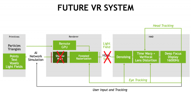

I have nVidia research data, “Brainwarp 16000Hz” :
