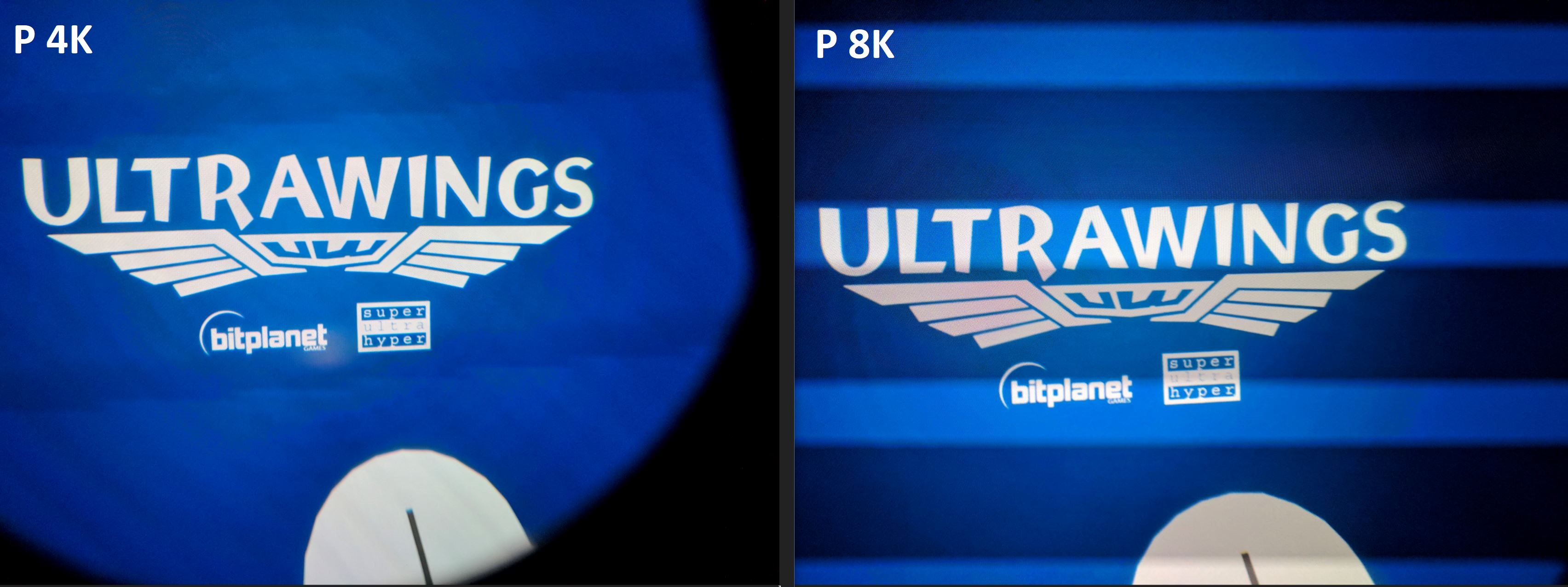

Made today a comparison of the Pimax 4K (Aukey 4K for 60$) vs Pimax 8K through the lens.
The pictures are not very good quality, because the Pimax 4K SDE is very small, it is quite difficult to catch.
But nevertheless, I offer for viewing and comparison (for now this is only in one game UltraWings. Later I will do it in others):
Yes, in terms of clarity and SDE 4K is easily ahead of 8K
But his FOV is rather narrow … + there is a ghosting (splitting of the picture).
P4K is clearly not for active games…
But for videos and simulators, it should go well, provided that you do not quickly turn your head
