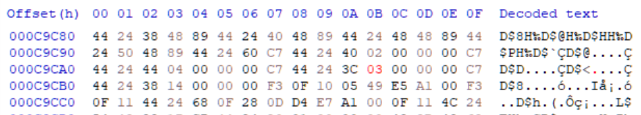

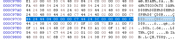

Update Mar 20: If you’re a Pimax user and want to get rid of the black hairline on the left and right sides of the HUD, AND you feel comfortable with hex editors like HxD , you can patch the pi_server.exe file yourself: while PiTool 1.0.1.275 is not running, just modify the byte at offset C97CB from 04 to 03 and save the file. Please only attempt this if you know what you’re doing, otherwise you run the risk of breaking your Pimax software installation.
Theres the one for .275

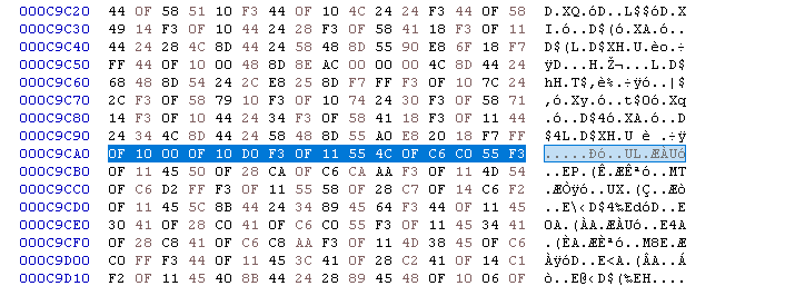

I searched the same row of V275 and found a completely different set of numbers.
It is currently difficult for me to know the correct row and the corrected value.

You may be able to copy the decoded info to the right on the unfixed version of .275 or .277 at the offset, then search for it in the other versions, but that sounds a little risky hahah
i bit the bullet and went to 277. still working! and found the 04 in the hex too, so no more black lines :metal:

thats because youre on .275, C9CAB is for .277 you need to go to C97CB
Your point helped me to find the relevant section. Thank you.
