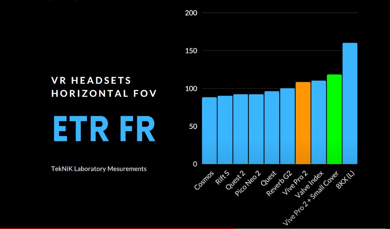

HTC Vive Pro 2: maximum FOV? (with measurements in Lab
Note: turn on the caption to see the English translation
Another test of the Vive Pro with FOV comparison with a thin foam

After reading and listening the objective aspects of the Vive pro 2 FOV, I am leaning to the conclusion that is not that the vertical resolution is terrible, is that the shape of the lenses been rectangular is creating an unnatural subliminal effect on the user. Pimax doesnt fit in the category due to the much larger FOV real state. But the Vive Pro still hovering around similar FOV as all modern consumer commercial Headsets making it quite obvious (that exclude Pimax as it is an enthusiast HMD)

P.S. 96° vFOV almost matches Pimax’ 100°, am I wrong? We’ll “mod” the VP2 slightly to get there. Very interesting.

96 indeed is close with only a difference of -6° from pimax’s rendered FoV. The number MRTV posted is rendered FoV in vertical and Horizontal. To that end a mod will not yield more than what is rendered as rendered is the max possible perceived FoV.
I am more curious on the Stereo overlap as the vertical and Horizontal FoV should be close to same value. From my understanding there would be only 2 ways to achieve a higher horizontal value - decreased stereo inbetween eyes or a distorted stretched image akin to what Tested initially described a 4:3 TV image stretched to 16:9. If it is a stretched warp it might be why some have said it is blurred compared to the G2 due to correcting the stretched image to lens projected image.
Indeed with Vrgineers’ HeroVR the FoV had a range of 150 horizontal to 170 iirc due to the eye relief. So likely also adjusted the distortion accordingly. Not sure if they continued this feature in the Xtal models.
