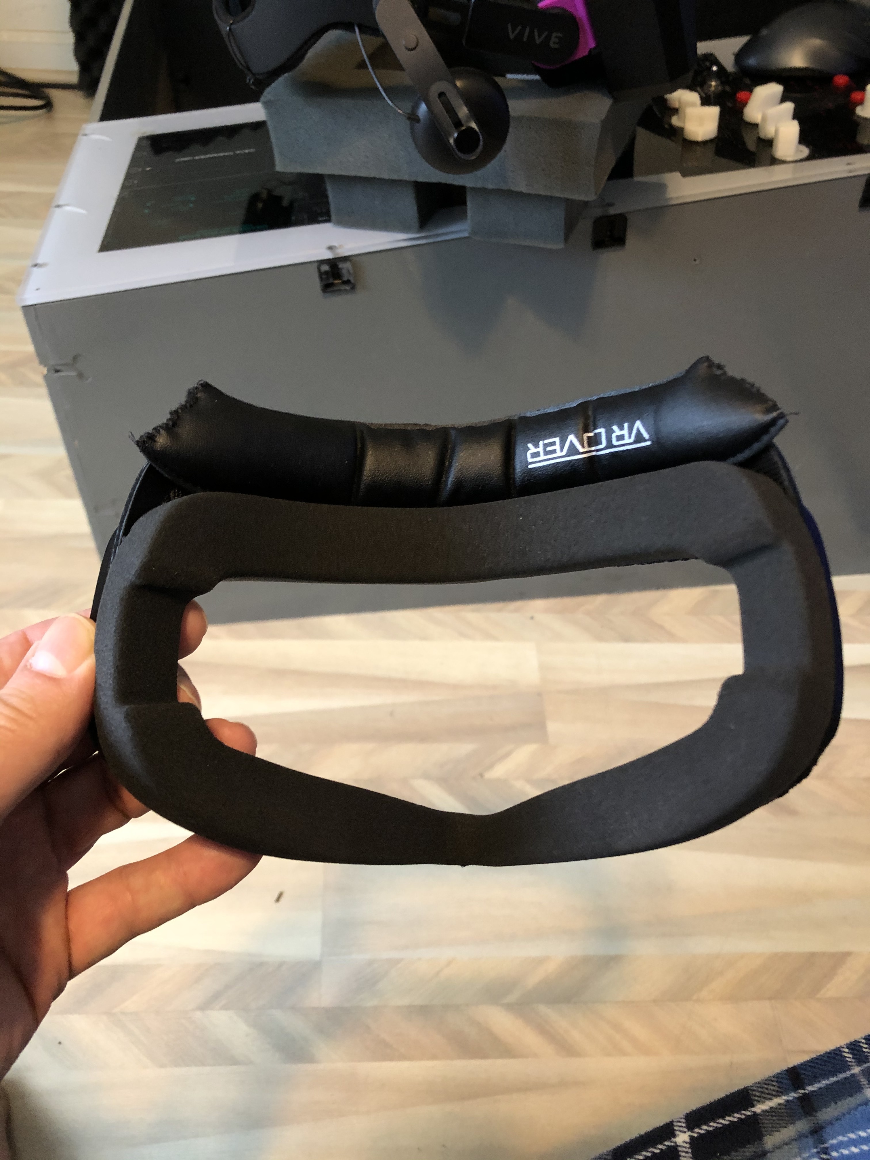

Here is another comfort mod that really made a difference for my 5k Plus. It grabs more of your forehead and makes it easier to make adjustments. I used the original foam plus added another layer on top.
