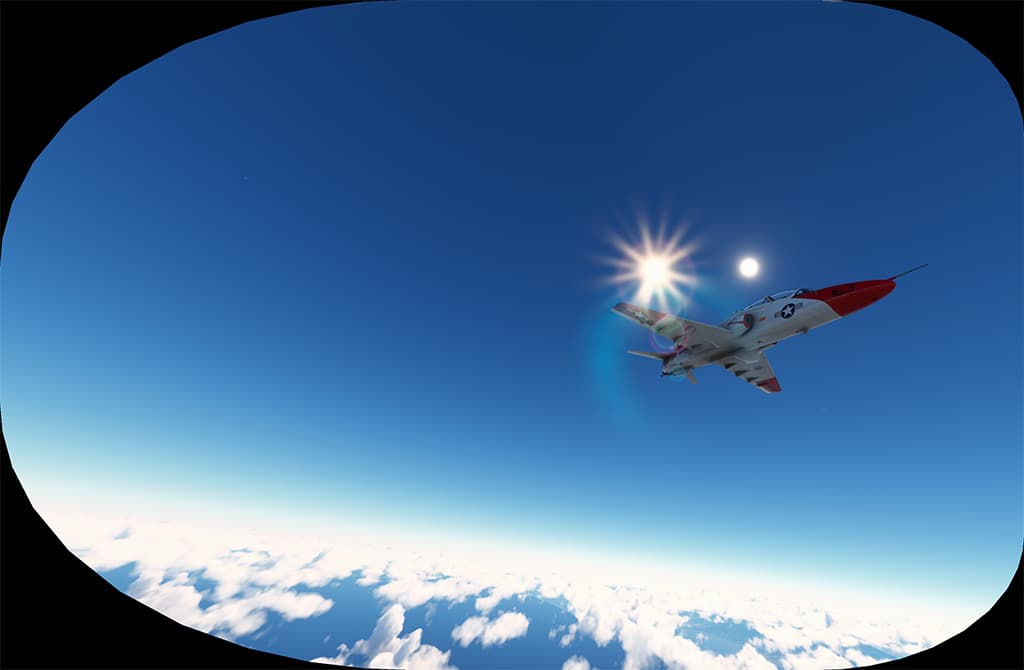

SU9 caused the lens flare in the left eye to appear displaced from the position of the sun during NoPP. Probably a post-processing miscalculation due to the tilted display. Does anyone else see this?

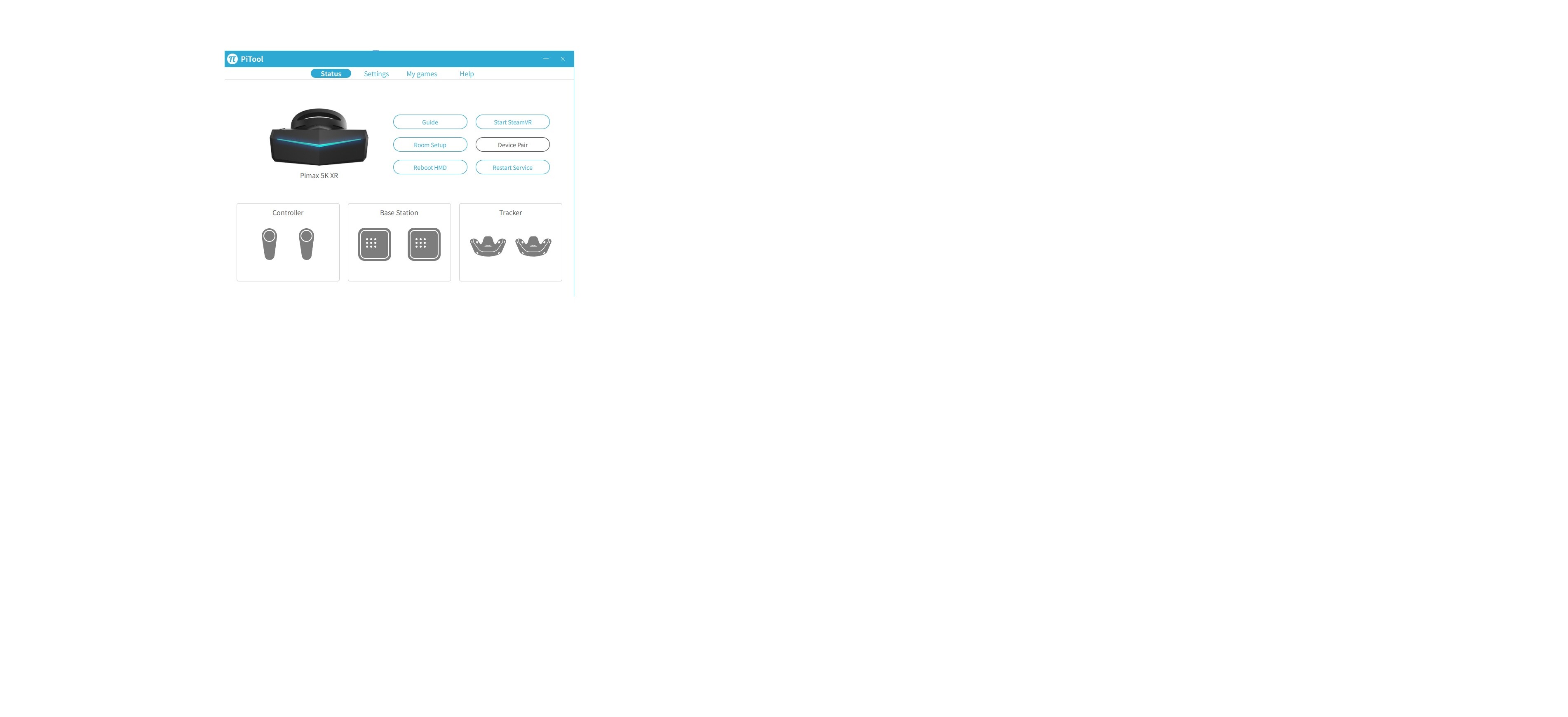

Hi I have the model of Pimax 5K XR shown in the photo but I can’t get it to go with MFS2020
I can have some help and always about
the Pimax using it in DCS when I want to get closer to the cockpit the distance remains unchanged
thanks for the answer
Max
Can’t get it to go isn’t a lot of detail. FS2020 takes a real real long time to load sometimes and can appear to have hung on launch. It can also hang on launch :grinning:
For this (6dof = 9 axis) you need 1 or 2 base stations for tracking, and you need to enable it in Pitool. Without it, you are doomed on 3dof only (just turning your head works, moving not).
