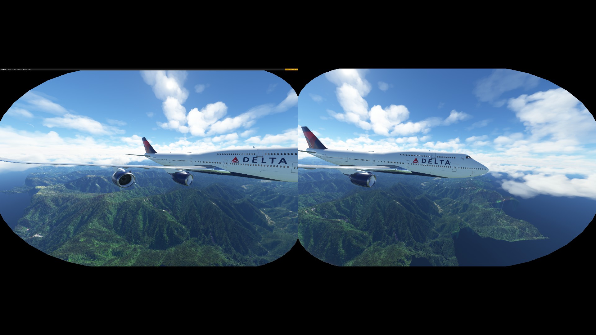

I tried FFR but stopped using it due to background rendering disorder (black horizontal lines) and screen shimmer. I turned it off as I am getting adequate performance.

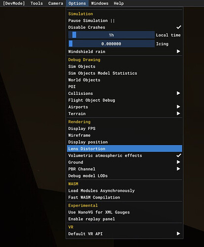

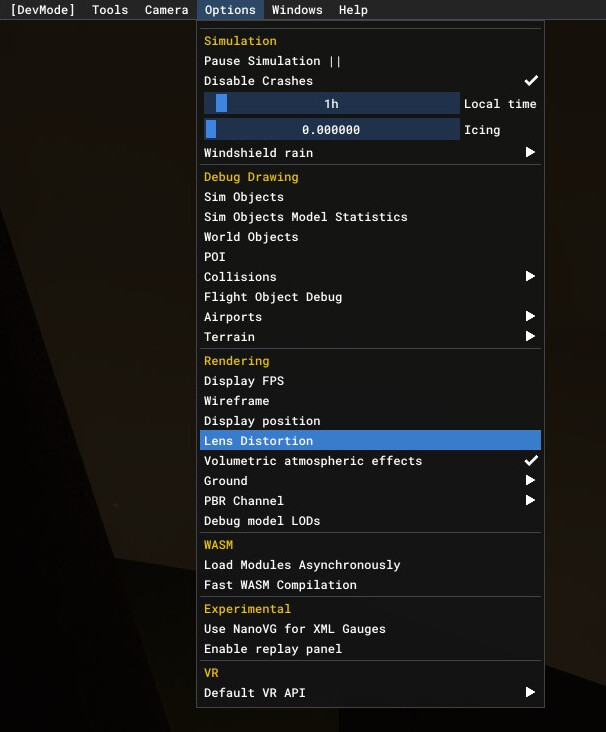

I also activated DevMode in msfs and turned off Lens Distortion to eliminate perspective compression.
I still feel that objects up close look larger and distant objects look smaller, but the look is much upgraded.

I don’t see any black horizontal lines with ffr :1 resolution in the inner ring, 1/2 between and 1/8 in the outer ring. It gives me more performance.
That’s the best way to go!
We’ve released a new version yesterday (1.0.2) and it greatly helps reducing the “black lines” effect when using 1/2x and 1/8x. You can even turn the Light shafts back on!

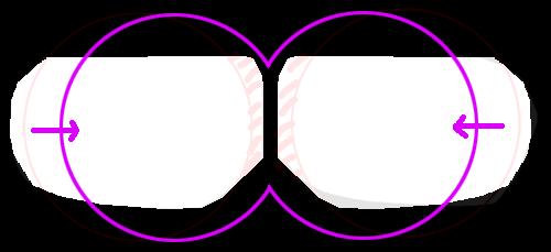

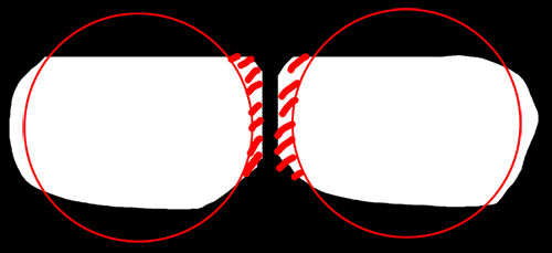

The FFR ring is closer to the outside and I see an area of low res on the nose.
I wanted to eliminate the inner low res, so I tried to center the FFR ring.
I would like to offset the left and right FFR rings to the center but the offset parameter does not bring any change.
The position of the FFR ring is completely fixed for both Preset and Custom in my environment.

For moving away from the nose area, you should be using negative value, have you tried that? Can you use the Cull mode (instead of 1x, 1/2x etc, when you select the resolution) to make the circles really visible while you experiment with offsets.

The culling also does not move the offset, just the circle in the center.
