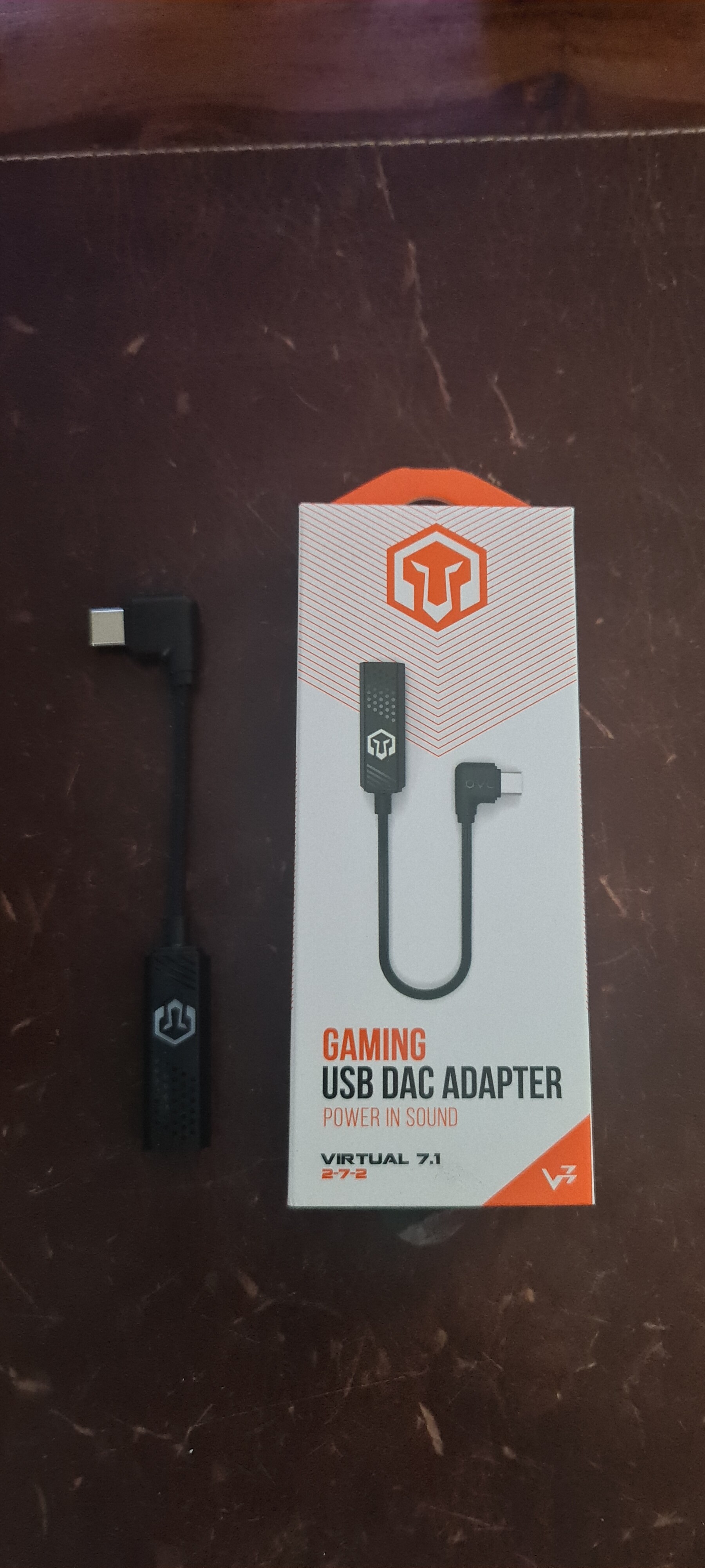

This USB DAC adapter works best so far.
It must be connected to the KDMAS Y cable.
This solves the problem for the time being.

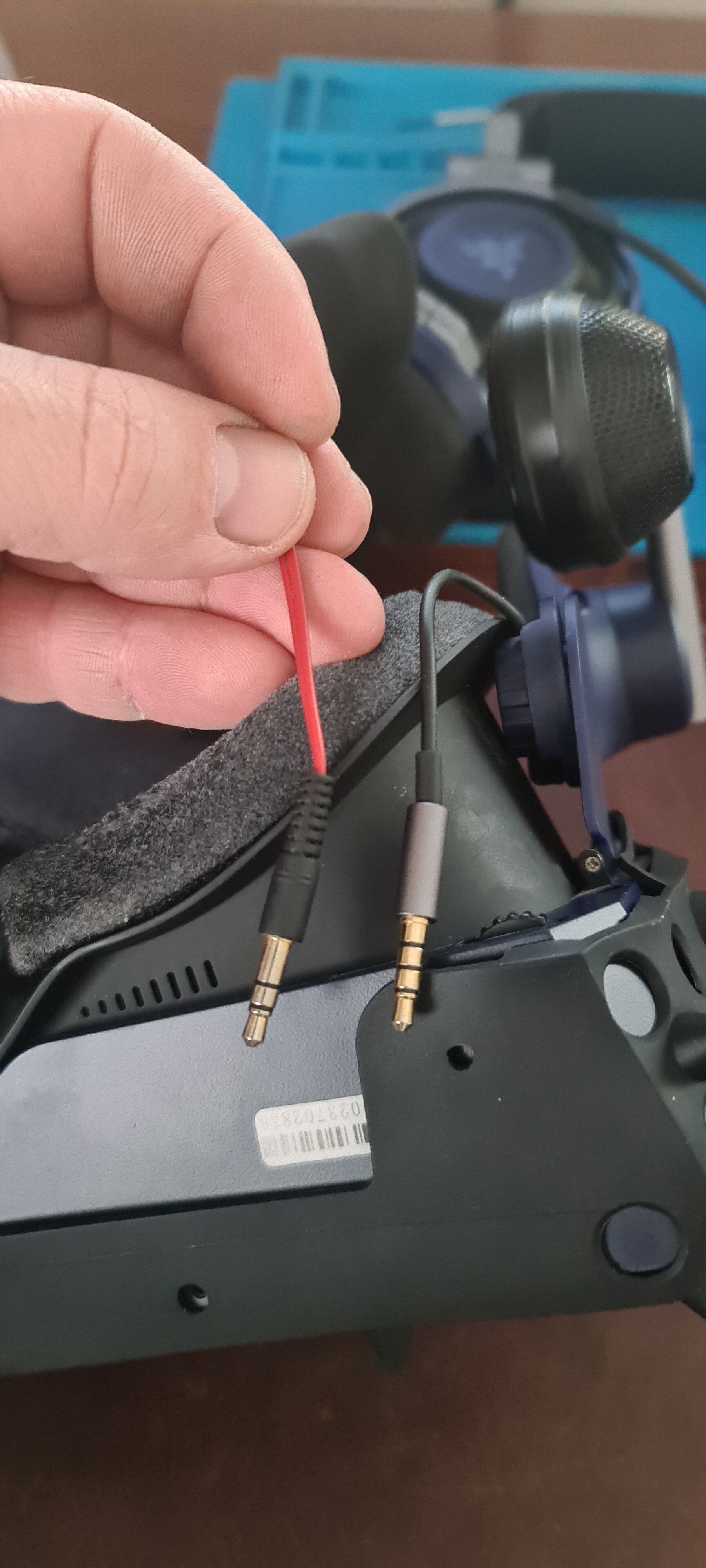

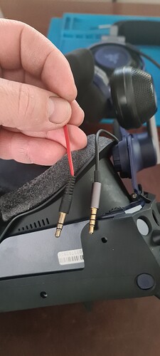

I found out that it has something to do with the different routes.
The plugs have different poles.
KDMAS with Y connectors only have three poles. Like cell phone headphones.
DMAS has four poles.
(see image)
If you only connect three poles and then reboot HMD clicks in Pitool.
then the whining is gone.
but as soon as you connect four poles, the whining is there again immediately!
can you reproduce that ???
So we are supposed to plug it in partially? Would this require a grommet to keep the positioning perfect?
4 poles (TRRS) is usually to accommodate a microphone in addition to stereo (and ground), so the DMAS only being mono would only really need 2 rings…
Whatever, if this fixes it, then that’s great.
They can do that and the whining is gone.
BUT the sound is quiet then.

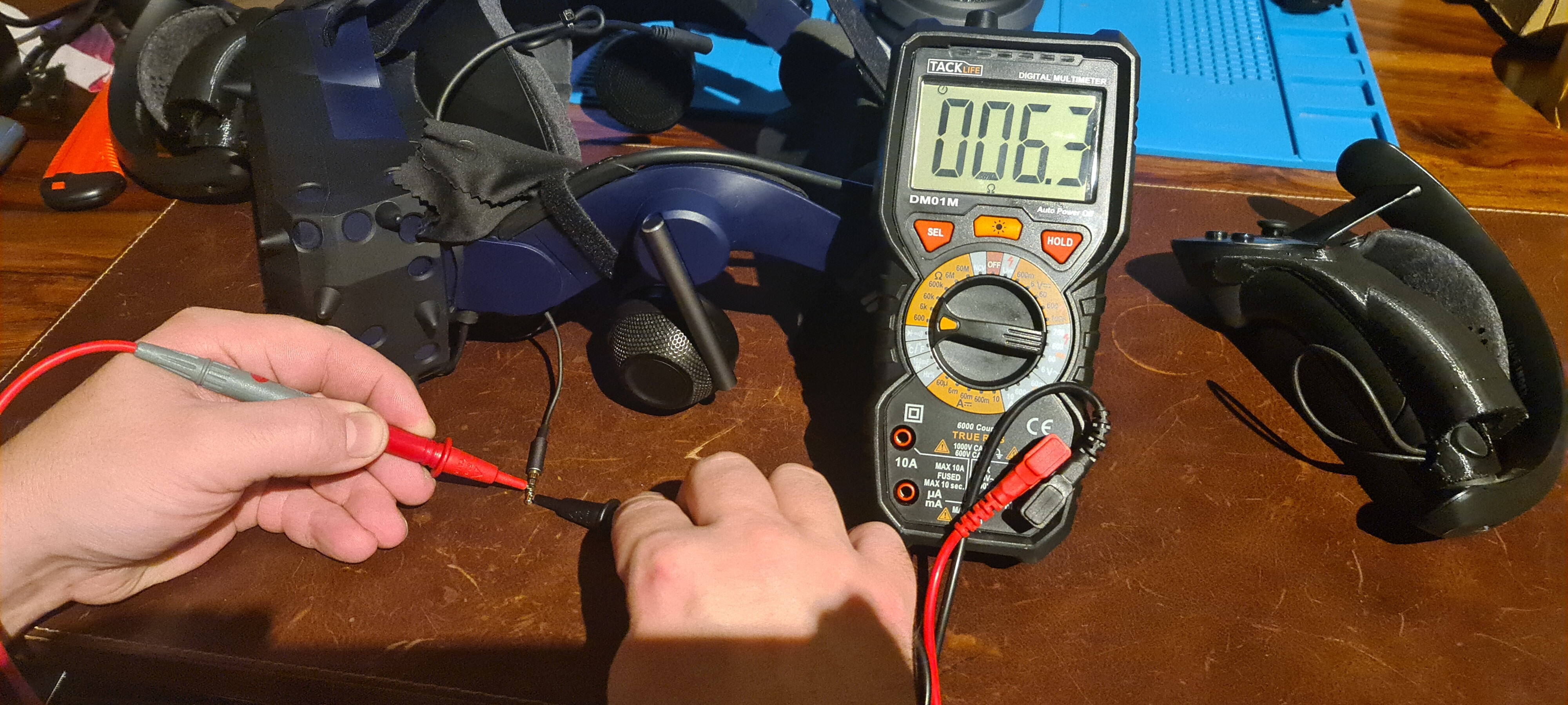

I created a cable of my own like so (same as not fully inserting):
3.5 mm (TRS) male plug going into the left socket on the headset (wired as usual) and 3.5 mm (TRS) sockets wired with only the tip as positive (left or right depending on which side it is) and the ring as negative and no connection on the sleeve.
The TRRS plugs on the DMAS are wired in a weird way and that seems to be the cause.
Also;
Mine measure about 6.8 ohm between the tip and ring on the plugs so they’re very low impedance which could explain the noise that people are experiencing when not using a splitter inserted to the left socket on the headset.
I think what happens when only having one side connected and restarting the headset is that the DAC/Amp inside probably switches gain (lower gain).
Seems to me that the output impedance of the headset DAC/Amp doesn’t match the input impedance of the DMAS very well (maybe there are different revisions causing different experiences?).
Same thing often happens when trying to drive low impedance IEMs of of a desktop amp.
Disclaimer: My tests have been conducted on a very early version of the DMAS… :wink:
I have 6.3 ohms
