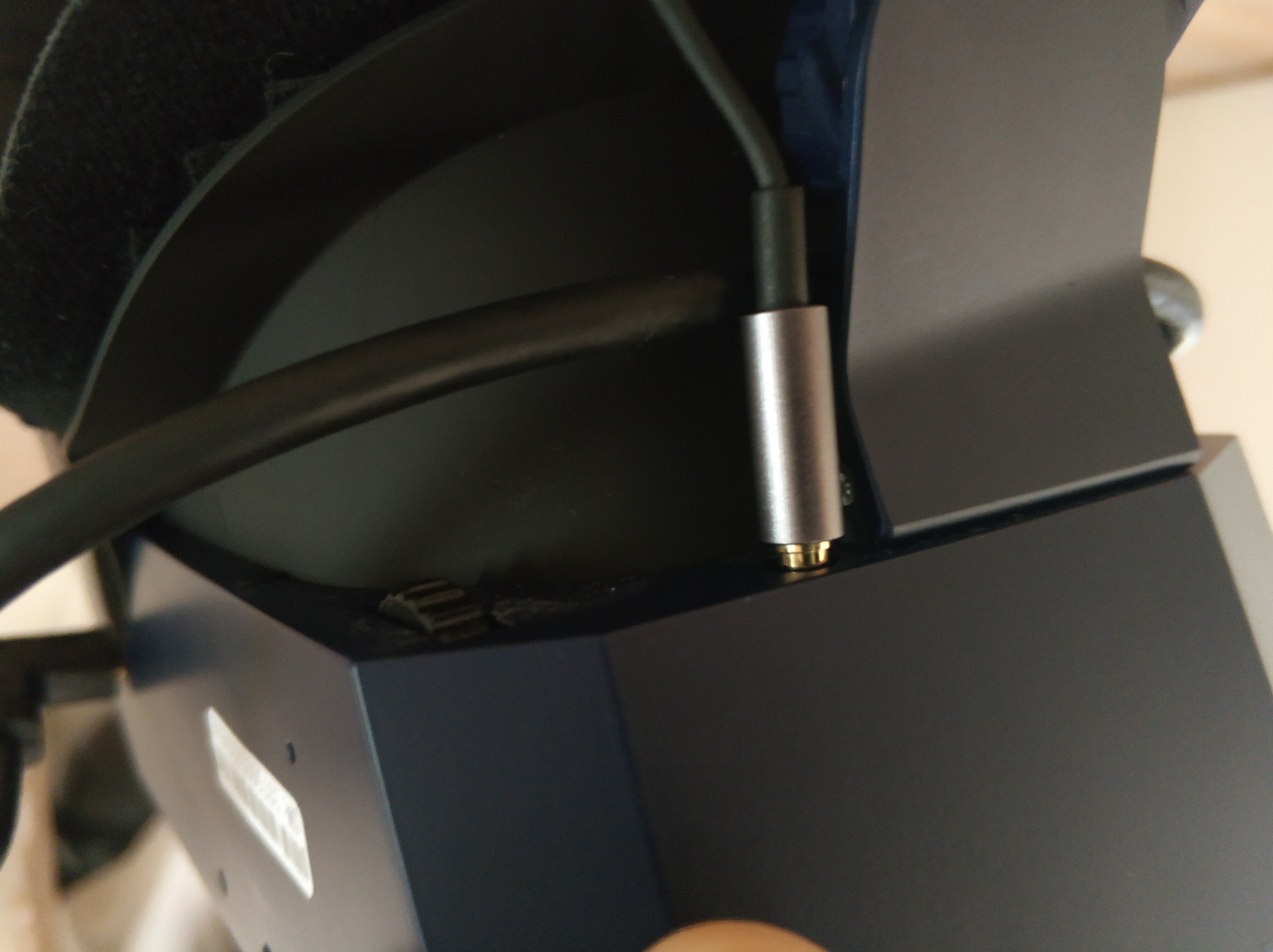

I think they won’t work because they don’t fit.
Pimax has 4 poles and the adapter 3 poles.
I think Pimax has a different wiring as usual.
Yeah, they will only work if You don’t fully insert them.
yes that is known. And then the volume is way too low.

I’m not saying we should be fixing this, but just like You I’m sharing my findings and for me, it works perfectly fine with the adapter/splitter I made though it’s ugly and I would rather not have to use a splitter.

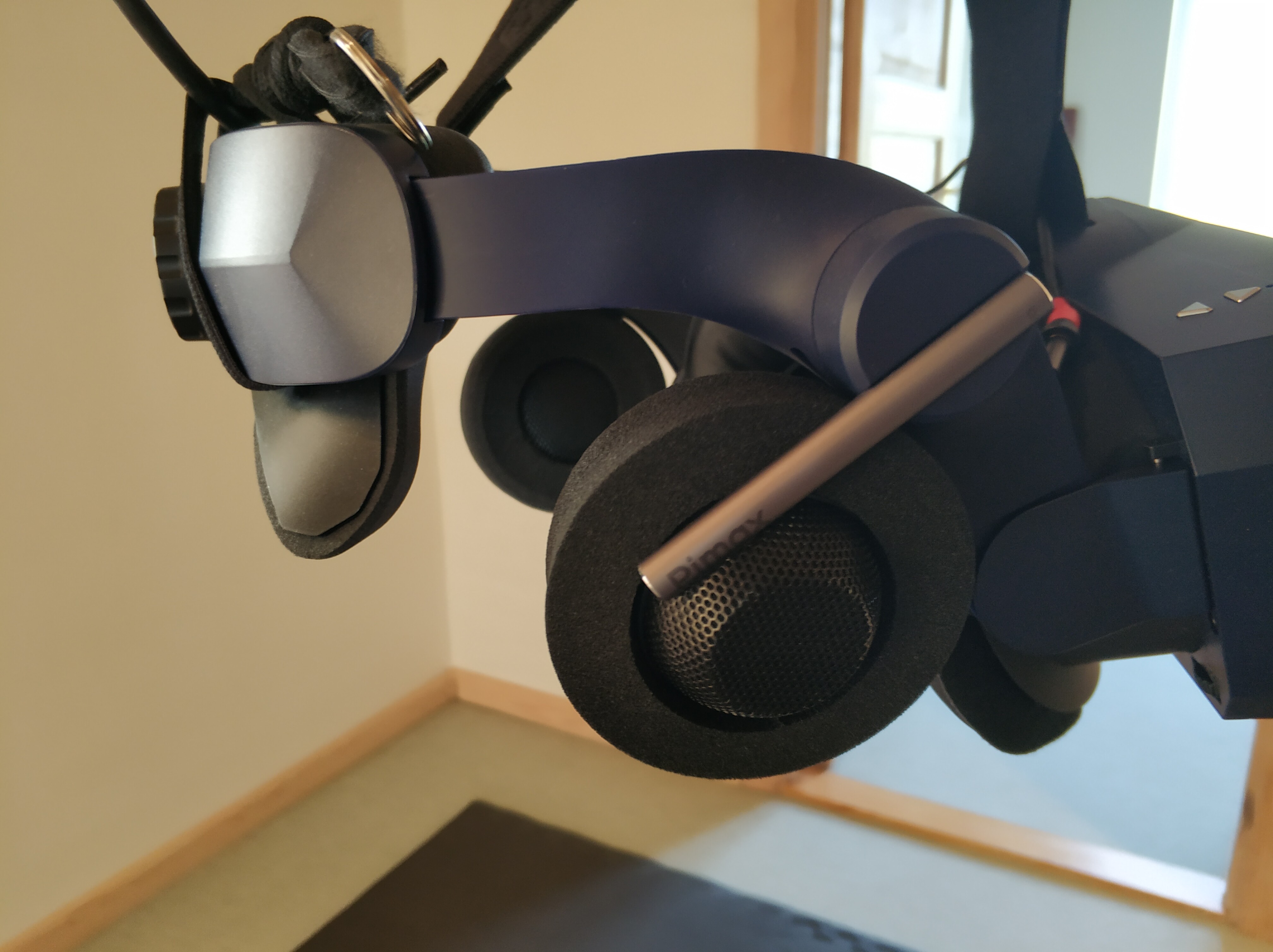

Update: While I’m not sure I like the sound better (more low end but You loose some of the top end which means they sound a bit muffled to me but some people like that) they fit pretty well:
I have a pretty narrow face so others might get even closer to the foam… :slightly_smiling_face:
TLDR; After attaching the DMAS (each plug goes to each side), try power cycling the headset completely (unplug/replug). If volume is low, You might need to let the connectors not be 100% inserted (leave half a mm - maybe add a tiny 0-ring to prevent fully inserting the plugs).
So, today was the first day I tried using the DMAS on my “new” 8KX without my homemade splitter cable and lo and behold: It works fine without it… :slight_smile:
Thing is I just installed the DMAS and put the splitter on immediately when I got my replacement 8KX (RMA’ed due to unrelated issue) so I never tried without it.
At first it was low volume but after power cycling (unplug/replug both USB plugs) it’s fine.
