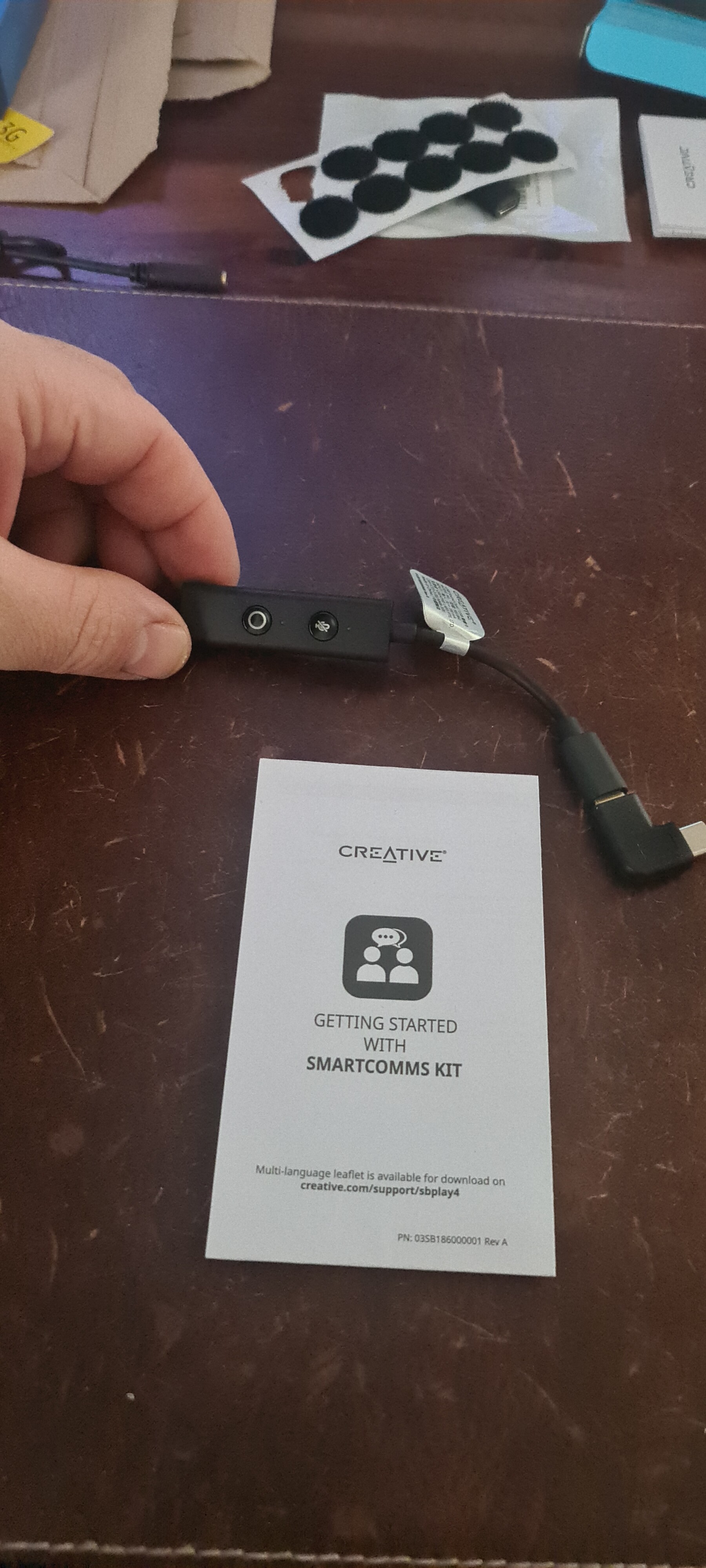

The little SoundBlaster is good. It makes a good sound and also has a bass reinforcement. Loud enough too. However, it seems to me that the speakers can’t do it.
I’ll get another sound blaster tomorrow.
Maybe he’s better.
I will test and give feedback.
You sure are using alot of cash on trying to solve a problem that is essentially a hardware defect in your 8KX HMD. :partying_face: Kudos for trying though. (save the money for an upgrade / replacement though) :wink:
I already had the G3 but it’s good to know the smaller one is louder. It’s only Ā£25, and my G3 was being used elsewhere as an optical in, so I’ll grab a Play 4 to free it back up.

Ok, new feedback The little SoundBlaster is also causing some problems.
As soon as it gets too loud … as with BeatSaber, switch the sound off to 100%.
The SoundBlaster can then no longer be found as a USB device.
