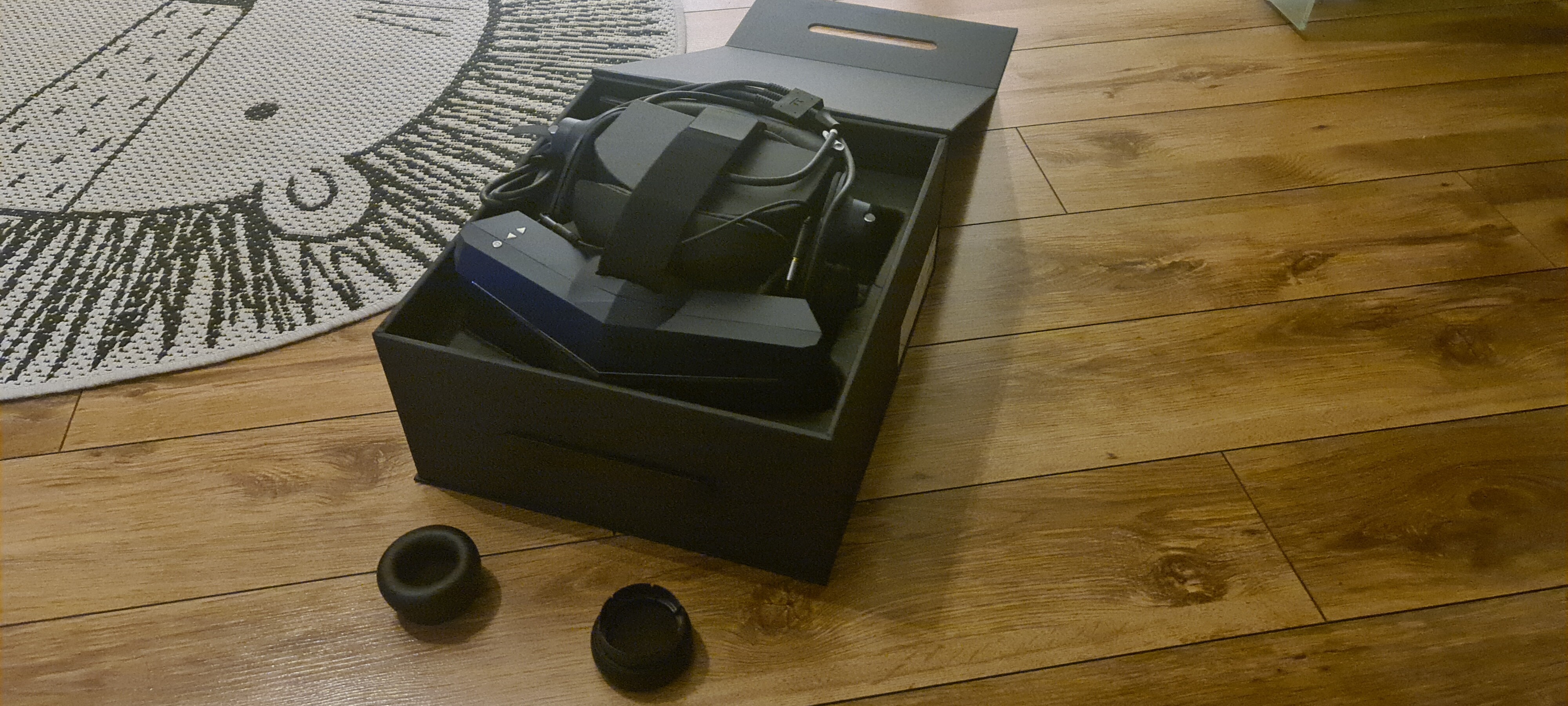

I’ve reported a lot about this problem! The whining comes from Pimax 8KX! Apparently the problem is defective hardware. Maybe a production problem!
Pimax Support sent me a NEW 8KX!
The problem is gone!
So to everyone out there with whining in the sound!
Open a support ticket !!!
Many thanks to the great support!
thank you very much Pimax Support!

Yes, you have to send the 8kx back first.
All I had to do was send it to a Pimax store near me.
You may have to pay the shipping costs yourself.

The problem for me was ONLY THE 8KX. Dmas works fine! Only 8KX defective.
Shipping cost: 20-30$
Both ways?
only one way. I just have to pay for that to be sent.
I got a new 8kx from Amazon for free.
