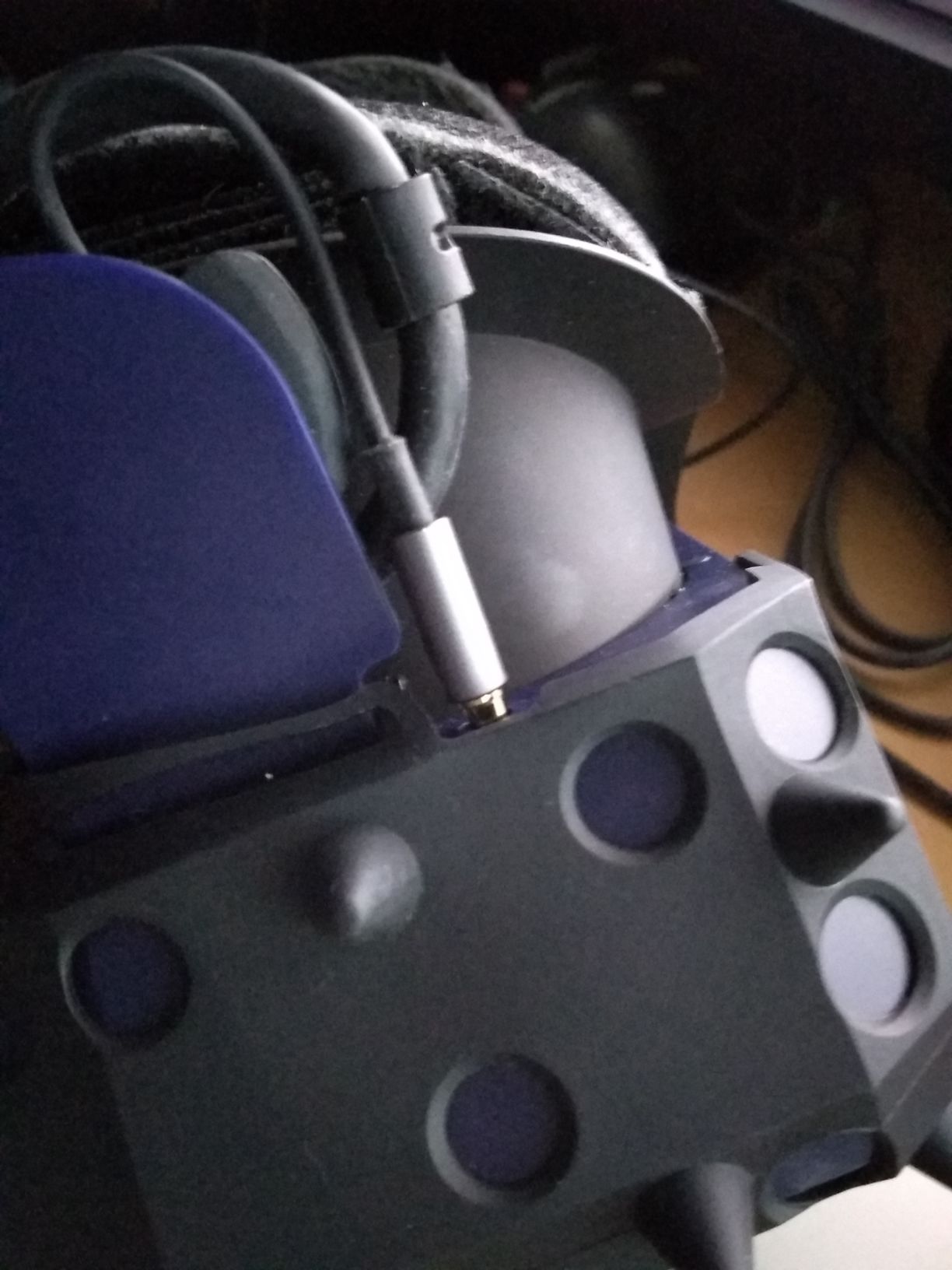

I just installed the DMAS and had the whine. After that I looked for this thread and found out issue with the side audio connectors from strap to headset.
After a little pushing out and in I found a position in which both sides have original volume and do not whine.
EDIT: I noticed though that both sound channels (left and right) are pushed to both speakers so I have no spatial sound. :weary:
EDIT2: So fully pushed in - no longer whining, Left and right channels separately are both high volume, center (both channels) are low volume.
Partially pushed out - no whining, same high volume across left, right, center (both).

So far Pimax posted me this video to try some more and I used it to tweak the connector depth of the connectors realtime until I found a very particular positions where I get stereo sound.
As you cans see Right is so far unplugged that the first insulator ring on the connector is showing, which makes it loose and a bit hard to keep in the very exact position needed.
