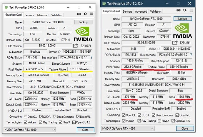

btw, your pixel fill rate and clock looks interesting. Are you undervolted? But it can also just be a power-saving option in the BIOS, and the values go up again under load.
I took that snapshot whilst mining on Nicehash to heat my apartment @ 60% PT. (Temps are currently 50c core and 52c memory junction). It’s not much, but it does offset my electricity bill.
There is nothing wrong with the card if that’s what you’re getting at:
This is @ .950 v, 2700 MHz core, +750 memory, peak power draw in Timespy: 350w, in gaming ~270-300w, as Derbauer pointed out, AD-102 is clocked way too far over the power / efficiency curve.
So basically, -4% performance vs 100% PT and default voltage / freq curve but with roughly 75w less power draw?
It’s not my card, or related to GPU load induced frame-time spikes, the issue happens in SteamVR Home with 35% GPU load.
Also, running the card in PCI-E Gen 3 doesn’t alleviate the problem but thanks for the suggestion.

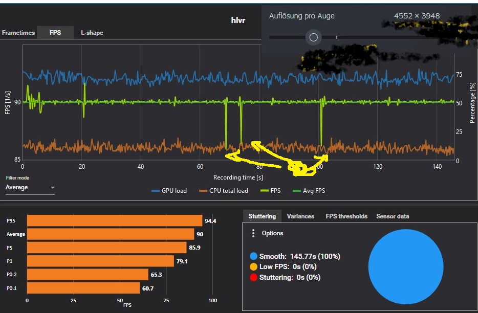

you’re repeating yourself, and bet you, I’ve shown once before, not just in words, but in graphs, that it’s not at every performance. The 10ms drop from 90 to 85FPS is irrelevant because you can’t see it.
But it doesn’t matter, you have your firm belief and no will to deviate from it. It can be, but it doesn’t have to be.

These aren’t frame-time spikes, when the stutter occurs there is nothing on the graph in fpsVR. Moreover, the primary issue isn’t the random frame-skipping, it’s the latency / lag that does not appear on a graph and that many people who claim to have no problems have honed in on this stuttering issue as though that’s the primary issue I’m describing.
I already stated the primary issue is latency / lag, the random frame-skipping that DOES NOT APPEAR ON MONITORING SOFTWARE I.E. FPSVR is annoying but not the primary issue.
