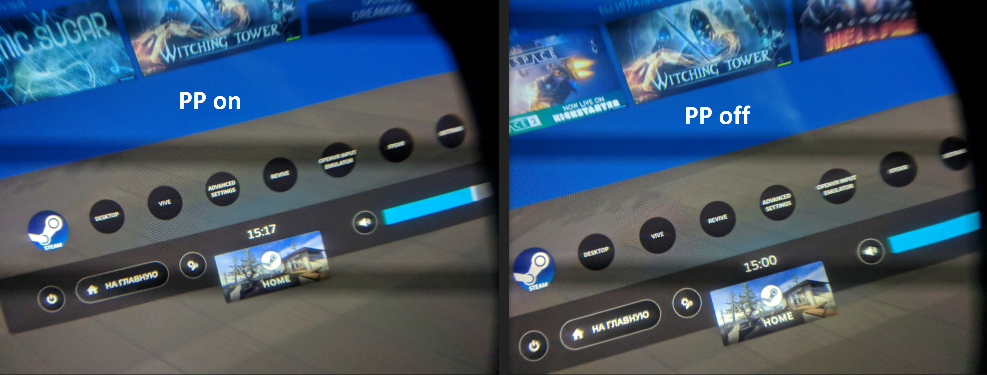

Do you now see a difference in the SteamVR dashboard, especially the texts at the bottom?
On SteamVR, I don’t see any difference at all. Everything is as usual there, if you mean this:
No, I mean the text on the round buttons for switching tabs such as ā€˜Steam’, ā€˜Desktop’, ā€˜Settings’ when you open the dashboard in VR.
I just started up the updated version of the game without Revive and it is broken, all windows too narrow. I also get the eye problem so I will stick to Revive for the moment. I am sure that the PP problem has nothing to do with Revive.
Well, there, too, everything is fine with me. I did not notice any problems.
Then I’ll check it again when I get together in VR.
You can read the buttons, only the letters are slightly blurred if PP is not working correctly and then you get the problems in Borderlands in my experience.
I made a comparison through the lens, but did not notice any global differences :thinking:
If you look closely at the letters you can see that the right ones are a bit brighter and have more clarity however that seems normal.
Have you restarted SteamVR since you last started the game and if so and you start Borderlands now is the minimap correct or not?
If you start the game and the windows are too narrow and the minimap is not correct then look at the buttons in the dashboard and see if you notice a difference.

What FOV are you using? The problem seems to be related to the FOV. Small or Normal mostly seem to work correctly including clear letters on the buttons on the SteamVR dashboard but Large rarely works correctly.
Good point - many games have issues with a that large field of view as devs don’t seem have it in focus and did not abstract the code enough to adapt dynamically.
I started playing BD3 recently, then switched to BD2VR when they patched it: O my! Much better! I miss the gun that I had in BD3, but this is much more fun in VR!!!
Yes but I play almost every game with large FOV and no problems. Also I had Borderlands working fine with large FOV a couple of days ago but as soon as I restarted SteamVR the problems were back again. Since then I haven’t been able to get it to work correctly with large FOV!
Now I have visually compared the difference several times with PP and without PP in SteamVR.
Yes, maybe you’re right, and with PP turned on, the letters are a little more vague on those buttons in the SteamVR menu.
But honestly, this is so insignificant for me that I have never even noticed this before :grin:

Yes the buttons are insignificant however now they give an indication of whether Borderlands will work correctly or not. If the letters are more vague Borderlands will not work correctly no matter the FOV.
To turn it around if Borderlands works correctly then those button letters look the same as no PP.
