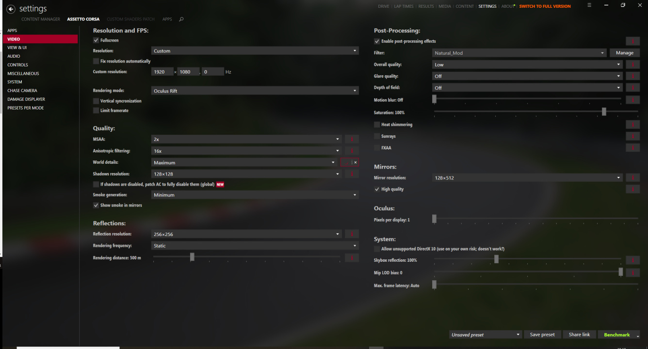

Are you not using content manager to adjust settings ?
Much more options
Find it easier and faster to load with content.
(pic from google, got full version :slight_smile: )
