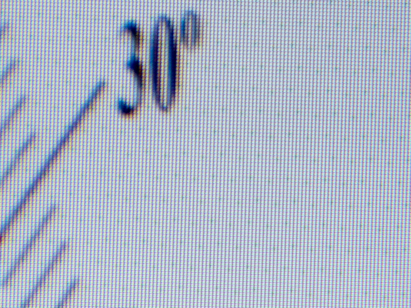

About the Pimax 5K+ Black dots Replacement
Do you see those dots on the white background?

Look to Red, Brown, Orange, White colour.

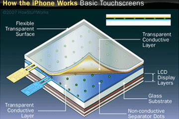

It appears that 1 or more batches of LCD panels (for the 5K+) were touch sensitive screens, which have additional layers on top of the LCD. Those dots are tiny spacers, which prevent 2 layers from touching, when no finger is pressing the layers together. It even makes sense that Pimax might have gotten a good deal on the panels, which are resistive and can only recognize a single touch-point. Capacitive multi-touch screens are far more popular, so the manufacturer might have been trying to dump some obsolete panels.
The solution is easy, for new units: Use non-touch LCD panels, which is generally cheaper, since it’s simpler.
https://community.openmr.ai/t/are-dots-in-5k-a-touch-system-look-at-this-images/13132?u=neal_white_iii

Yes, but many of us never actually believed that. If you follow the link in my previous post above, you’ll see that the diagrams look exactly like the black dot effect…
