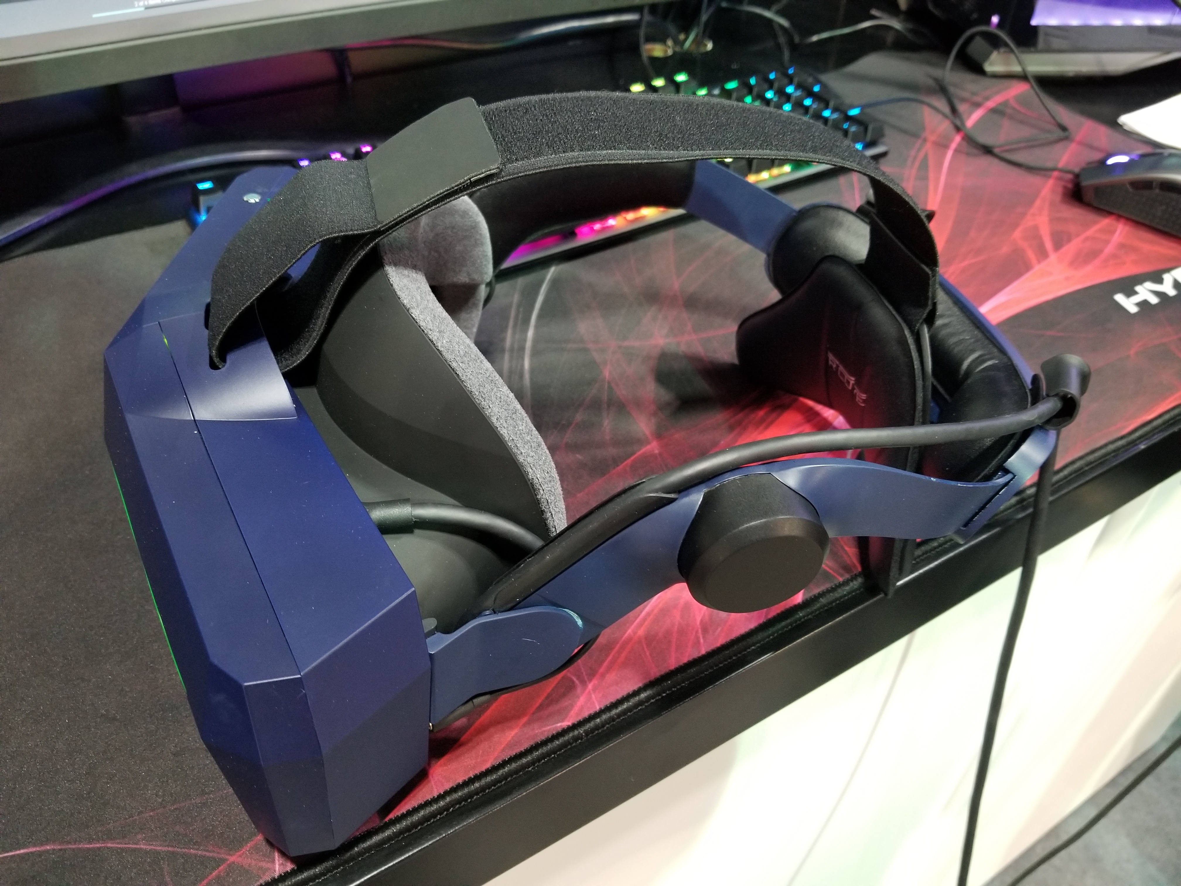

Anyway, here are some close-up photos I have of the SMAS from CES 2020. People (including me) liked this, so things went wrong between then and now.

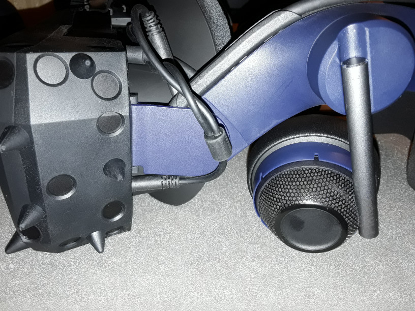

Below is a picture of the max angle the endstops will allow:
In one of the Pimax updates, they wrote that we are supposed to apply some force to put it lower. So I guess this was their answer to the issue.
i wouldnt recommend that, especially if you have the metal hinges. Even the plastic ones i wouldnt recommend that, although its possible and i have tried it myself - they can fail later on though.
It is in the Pimax tutorial yes, but for me this not even a workaround.
This endstop is certainly not meant to be overcomed, what would be the point of having an endstop at all then ?
This hinge just seem to have been produced with a wrong travel angle, many people here seem to draw the same conclusion.
