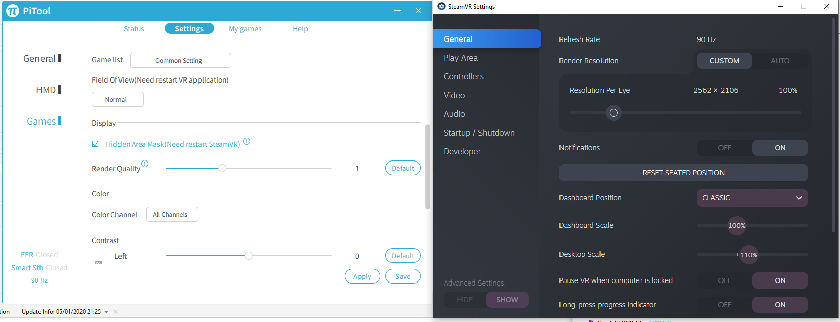

Still doing some testing but getting, what I think, are some funky steamvr settings
Render Quality is set to 1 but Steam VR says the 100% resolution is 2562*2106.
Shouldnt it be 3840*2160 or am I getting confused?

If I up the Steam values to match the headset display then it makes no difference to the display.
If I up the render quality then the display becomes much clearer but the sacrifice is unplayable frame rates (4fps).
Think there must be something up with my setup and drivers etc.
That’s the panel res, which is not relevant. The video signal to the 8K is only 2560x1440, so the res you are seeing in SteamVR includes some super-sampling.
SteamVR reports the rendering area size. The rendering area is based on your FOV, vertical offset, and PiTool quality (and possibly other factors I’m not aware of).
ok well at that res setting far detail is not as clear as the index, which I dont think is correct
The blurriness could be due to the SteamVR “maxRecommendedResolution” setting. The limit is too low for Pimax headsets and is especially noticeable with Parallel Projection enabled or when using Wide FOV. Have you tweaked your steamvr.vrsettings file? If not, you should. For more info, go here and follow the links: https://community.openmr.ai/t/new-hp-4k-hmd-599/17380/499?u=neal_white_iii
I’ve set mine to 12288.
yeah I set that to 8122 or something, will try your setting and see how that changes things
yeah tried that, no difference, its basically looking from the glass doors into the steam VR home at the back wall tv that lists all the games. Just a little less clear than the index but could just be my eyes and the sweet spot in the lenses.

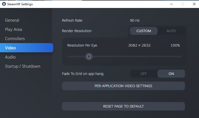

@neonrazor Strangely my 8K+ Steam VR value is 3082*2632 at 100% and Pitool at 1.0. It has more clarity than Index at this setting. My 8K+ is an engineering model though.
Edit: I am on normal FOV.
Yanfeng are you by chance maybe running a test release version of pitool?
No I am running the latest official version of pitool.
PP on or off…?
HAM on or off…?
Offset?
All of those settings will impact the rendering resolution.
