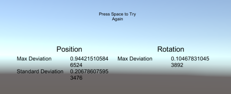

Have you guys used the Jitter test SW to make measurements?
Here is my 3 basestation measurement, pretty bad compared to measurements you can find online with an Index.
Hi Milopapa
Well according to the software my jitter is worse than yours :sweat_smile:

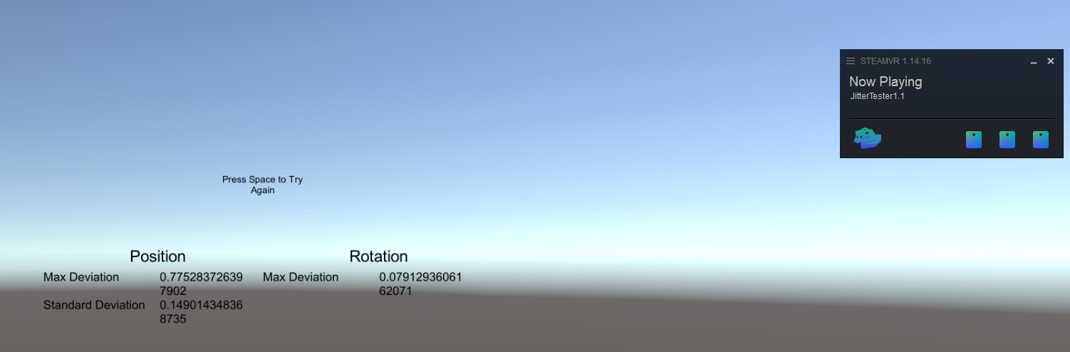

Will compare to my 5K+ later
5K+ jitter test, exact same LH 2.0 setup
No wonder I think my 8Kx is worse… :cry:
