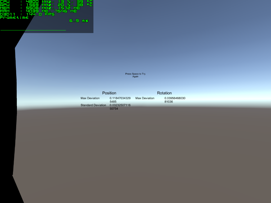

JitterTest with 2pcs. LH 2.0s
@Milopapa Jeez, my 5K+ and 2pcs. LH2.0 is better than even your 8Kx and 3pcs. LH2.0 :disappointed_relieved:

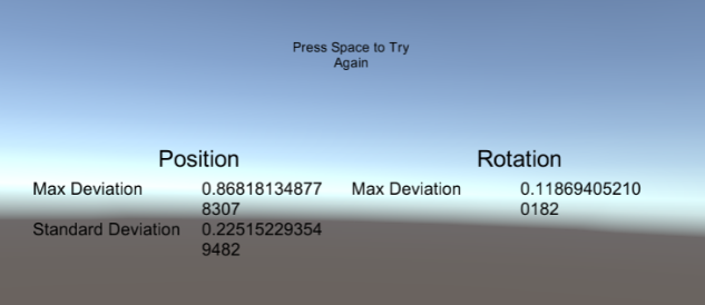

8Kx
5K+ exact same LH 2.0 setup
No wonder I think my 8Kx is worse… :cry: it’s practically twice as bad… horrible for a $1300 device

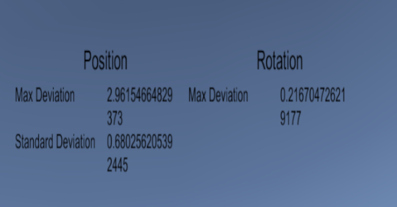

1
I have done the Jitter test and these are the results with 2 Valve LH 2.0
