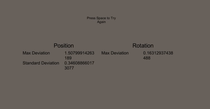

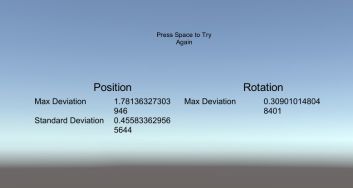

I have repeated the test without foil, with a single layer and with a double layer of dark foil. The difference is really little, at least at that exact point where I have positioned the HMD and I have even marked the position to repeat the tests in exactly the same place.
Results:
Without dark foil:
Max Deviation 1.78
Standard Deviation 0.45
Rotation 0.3
resized_Sin lamina
With dark foil:
Max Deviation 1.73
Standard Deviation 0.35
Rotation 0.18
resized_con una lamina
With double dark foil:
Max Deviation 1.56
Standard Deviation 0.34
Rotation 0.23
resized_Doble lamina
On the other hand, I have been able to take photos of the sensors with an infrared light flashlight and the mobile camera. And there is total transparency of the case and the foil. I have also picked up some Knuckles sensors and they look very similar, except that the housing is opaque and there is only a small circle uncovering the sensor.
So I come to the conclusion that it is not the transparent housing or the blue paint that is the culprit, and that it does not greatly improve putting fancy filters to the sensors, but it does help stabilize the jitter.
I’m afraid the way it interprets the signals from the valve base stations 2.0 should be optimized to filter out jitter. Perhaps it is to interpret the signals of the 1.0 base stations, which I understand have another way of transmitting the positioning and synchronization between them.
And by the way, when removing the pieces of black sheet, the blue coating has been tinted and there is no way to remove it, at least with alcohol. What a grace, but it does not affect the bad monitoring that I already have. For the moment I will continue with the double dark foil and the protective silicone sleeve.

Now THIS is what I call a well documented experiment. Well done.
The only thing is, these numbers seem to vary between measurements without changing anything, so I’m afraid the variance is within margin of errors. I could produce results similar to your numbers simply by pressing space repeatedly.
So unfortunately I agree with you, the foil doesn’t seem to do much to improve the tracking.
