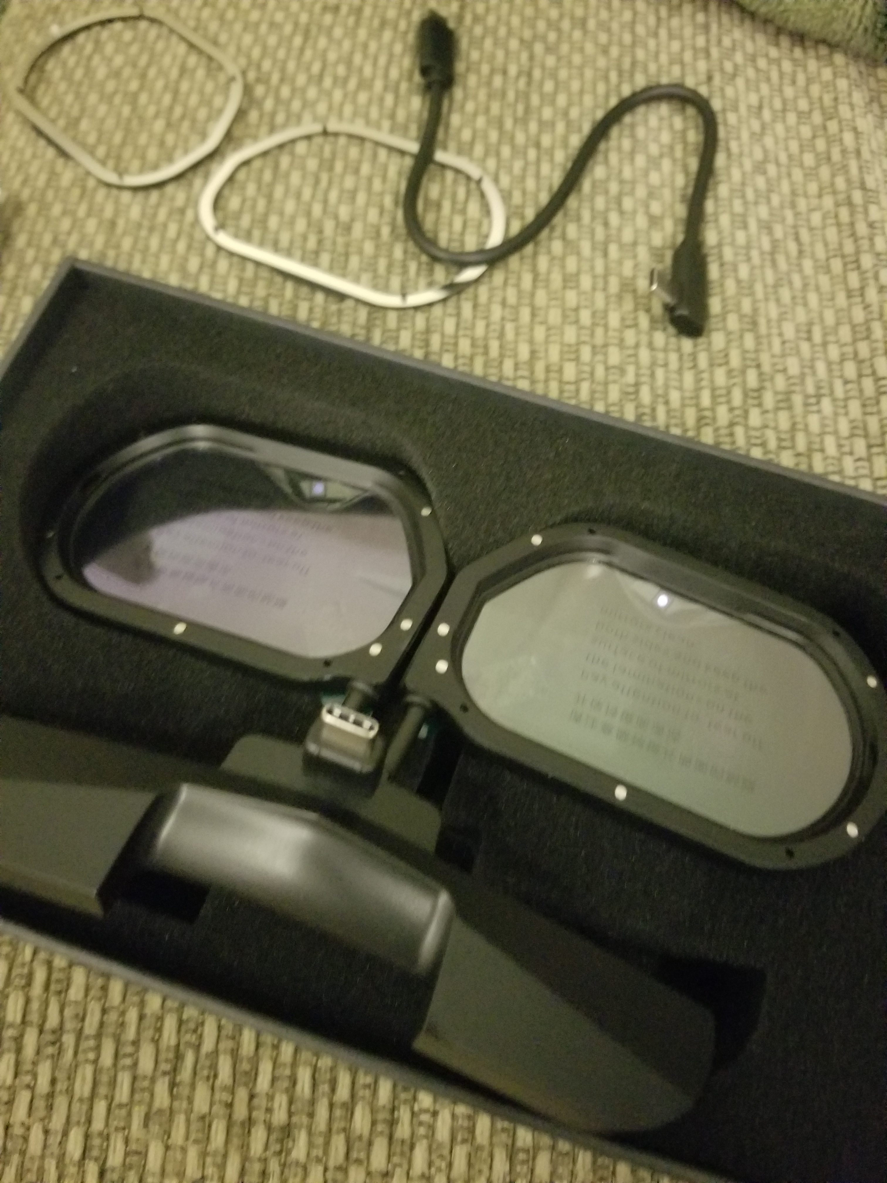

I got my eye tracking module today and it says to remove the sponge mask. Well I removed the foam and the face cowling. But I don’t see any USB C port that the eye tracking is supposed to plug into.
Do I need to remove the fabric too? I can’t seem to pull it off. It’s stuck on there. Also where is that eye tracking installation video? I can’t find it anymore.
Okay so I’ve figured out how to install it and calibration worked just fine. I have the eye tracking module plugged into the 8KX and it seems to only be running at 30fps.
I don’t notice any performance improvement at all in Pavlov for example. I’ll need to buy the longer usb 3.0 cable and plug it into my PC.
