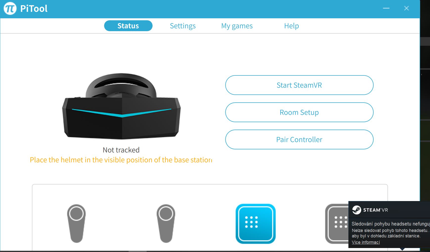

can you do a screenshot of pitool?

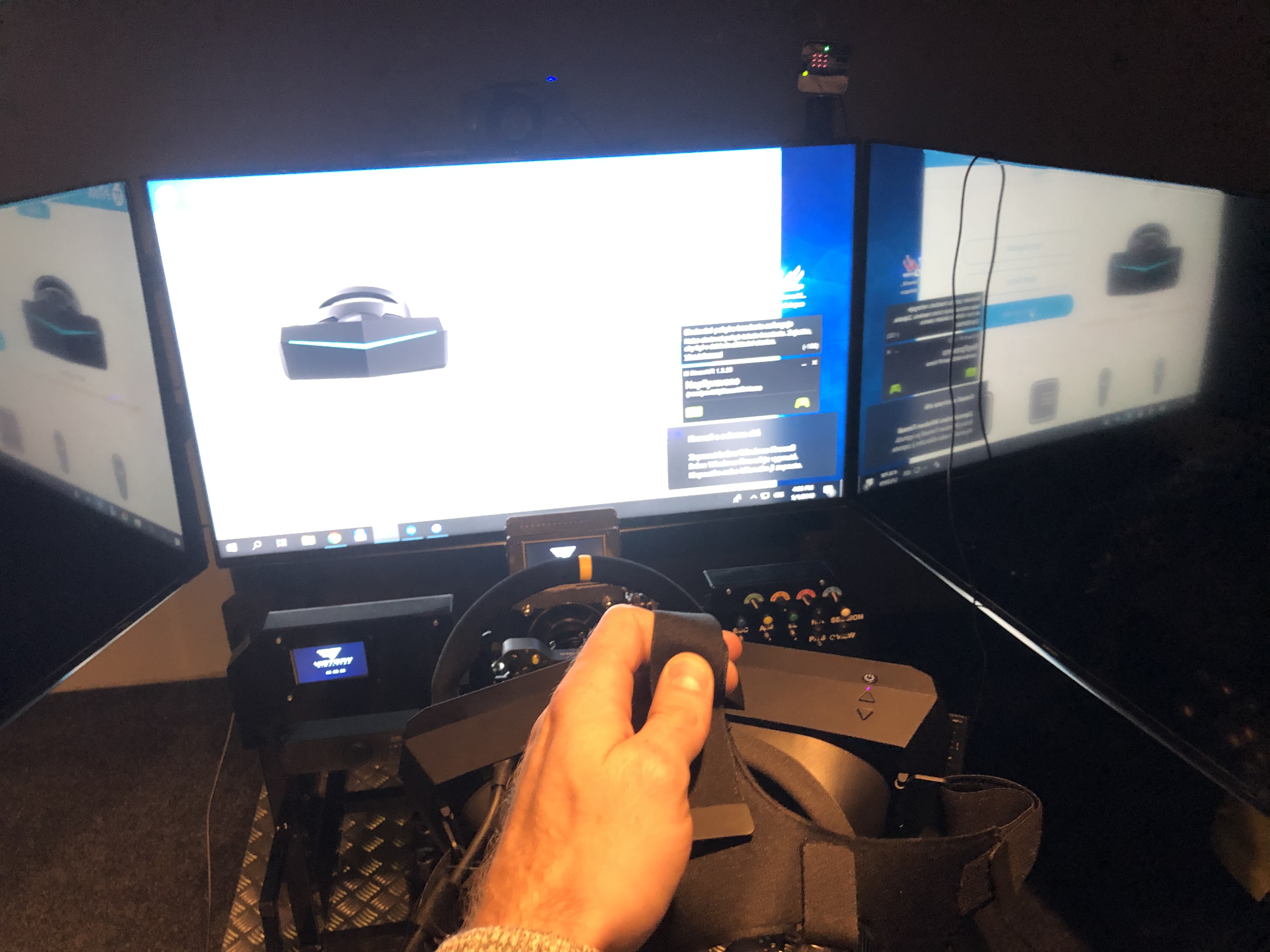

Well i have lighthouse on place of old oculus sensor - ca 90cm from headset, top right corner.

Your screenshot shows hmd is not tracked. @neal_white_iii found 2m away worked for LH
Well you guys are probably right, it seems that problems are caused by position of LH - looks like it need to be higher and more far away…
I´ve experimented with photogrative tripod and after LOT OF trying i´ve found a place where it even let me run the assetto corsa and run a few laps:-)
Well tracking is WAY better then with gyro…
But it is very sensitive - when i make some “bad” head movement it looses tracking for a second immediatelly, i do not think it should work like that… Will experiment with position of LH some more and probably 3D print some LH wall holder or something like that (btw anybody knows what thread is in Vive LH - standart european M6 does not fit…).
