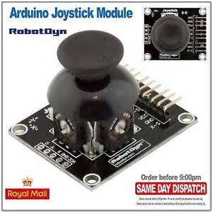

Here’s a joystick module from the Arduino kits, perhaps you could get some idea of sizes from this, and how many pins are required for the output.
