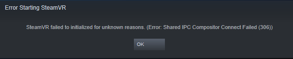

Wish I could test this… Keep getting this:

If you check the steam comments. Most other people are getting the same error.
Yeah I did. Tried uninstalling Natural Locomotion but it made no difference, hope they can get it straightened out soon.
You have wireless, don’t you?
It doesn’t work with wireless yet unless you have a Vive pro.
Nope wired up and it doesnt work. Also Checked and I don’t have OpenVR Input Emulator either which can also cause the issue.
Working now apparently Uninstalling Natural Locomotion still left behind a DLL.
@Heathen, Chubchub: Looks like you both still have a driver_00natural.dll hanging around:
Wed Oct 17 2018 21:37:56.909 - Loaded server driver 00natural (IServerTrackedDeviceProvider_004) from d:\Games\Steam\config\00natural\bin\win64\driver_00natural.dll
Wed Oct 17 2018 23:37:15.038 - Loaded server driver 00natural (IServerTrackedDeviceProvider_004) from E:\SteamLibrary\steamapps\common\Natural Locomotion\driver\00natural\bin\win64\driver_00natural.dll
Can you have a look in the respective folders to see if it’s still actually there? Double-check that Natural Locomotion is uninstalled from Steam - I’m wondering if there’s something wrong with its uninstallation process. (Did you have SteamVR running when uninstalling?)
Thanks!

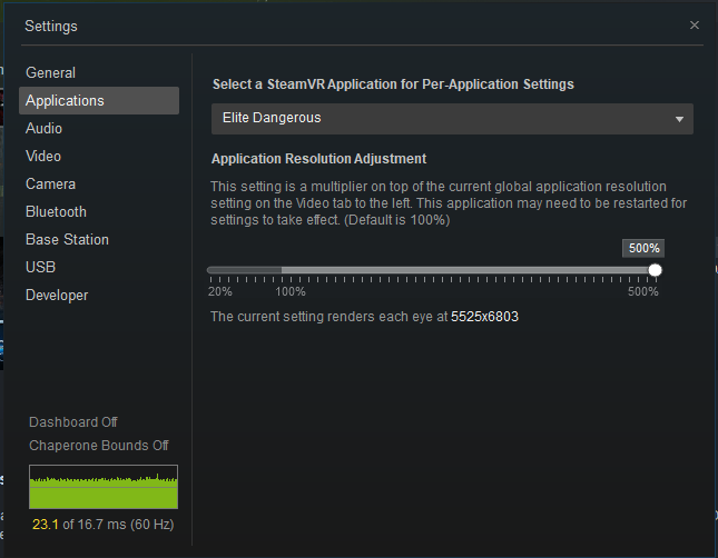

innitially i was unable to get the motion smoothing to kick in as even though i run piplay at 3.0 and my fav game Elite Dangerous in VR Ultra, my FPS was high enough for the new feature to not start! so i forced it :smiley:
i did it by changing StreamVR application rendering from 100% to 500% as show here
and leaving all my other setting alone forced the motion smoothing to kick in. you can see that the render per eye in steamvr is showing as 5525x6803 - yet i smoothly took off from a station cube and left without any lag that i could see. also as a sad side note, the ghosting is still there :frowning:
but if i tried this 500% in steamvr i would usually have killed my game so im quite impressed.

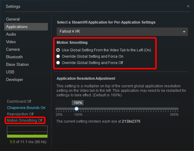

Nope… you don’t even have the option in SteamVR. It should look like this:
When motion smoothing kicks in, it says “Motion Smoothing: On”
