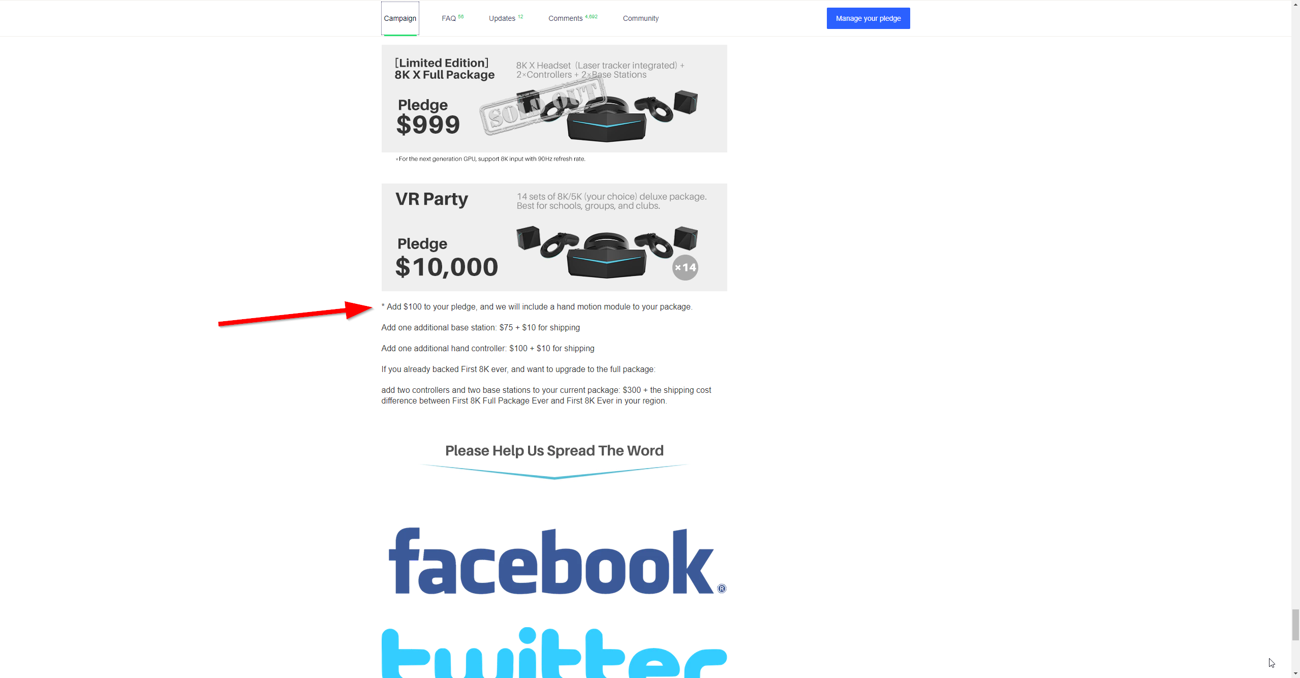

Where did this $75 + $10 shipping figure for a Pimax Lighthouse base station come from? I haven’t seen it around except in other comments from other backers. Is there an official comment on this?
It’s on the main campaign page, you will have to scroll down a lot to find it.
@brian91292 - ah excellent, thanks! I upped my pledge to $614 then ($529 + $85) I guess they will send a survey when the kickstarter is done.
