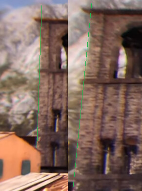

Doesnt look like distortion but blurring. hard to say from the video. from 2:33-39 does have a diffused tunnel effect
In the left image the tower is caving towards the left on the top, while in the right image it’s caving towards the right, around the middle. I see it exactly like that, there’s constantly this ‘wave’ going through the image.
Maybe they need to tweak the barrel distortion shaders?
I’m hoping they’re going to do what @heliosurge said and apply a dynamic distortion profile, based on the position of the iris. StarVR claimed that that’s how they solved it and it makes a lot of sense

Thanks @twack3r! They’re shipping me a replacement unit. Hopefully they can improve the distortion, I don’t think I can go back to any other headset :slight_smile:

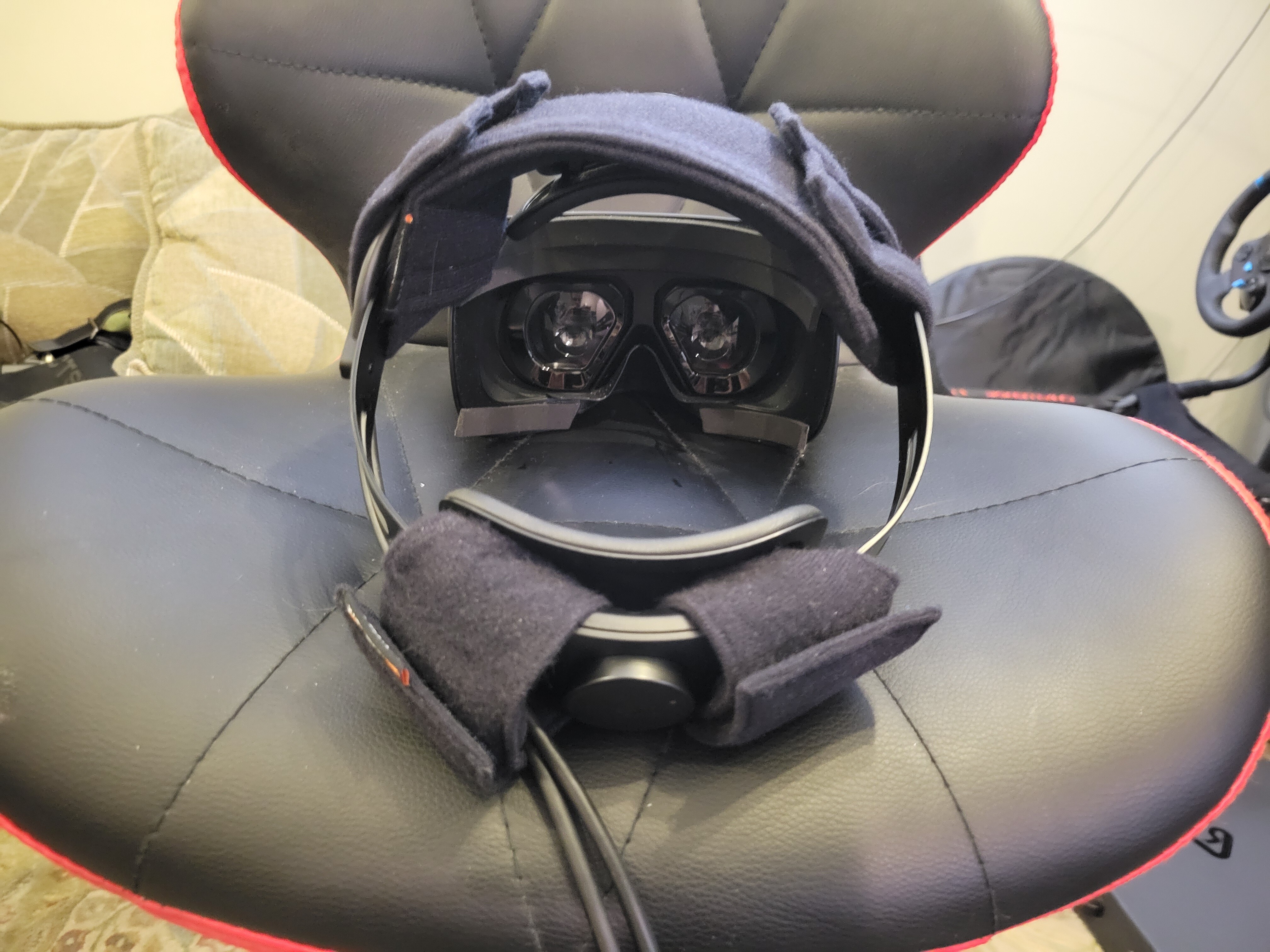

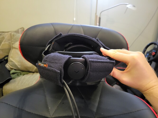

Good news guys. I managed to fit the Pimax Studioform counterweights through the gap in the back. The headset is now way more comfortable by having the weight distribution in the back. However it was a bit of a pain to squeeze the fabric through the gap, so I told the Studioform creator to make a thinner version of the fabric. Here’s a video: I moved the counterweights on my Varjo VR-3 to the back by fitting them through the gap in the back - YouTube
Knob access is still easy because you can slide the weights out a bit but it doesnt slide too far
what is the weight with counter weight? i cope with index with CW but 8kx with CW and DAS strap is too much for my neck
I haven’t measured. With 300g of counterweights it feels like the back is too heavy with that weighty cable. Once I hooked up my headset cable to a ceiling cable management system though, the counterweights feel perfectly balanced with the front weight. But Studioform will send me 200g and 300g samples with a different design to try as well.

But as long as they know your iris position, they could correct for it, right? Really hoping Varjo is looking into that. Although not sure if the eye tracker is accurate enough. In the Varjo demo I can see it works but not 100% accurate (it can point slightly away from the object I look at. Then again, it’s always pretty close).
