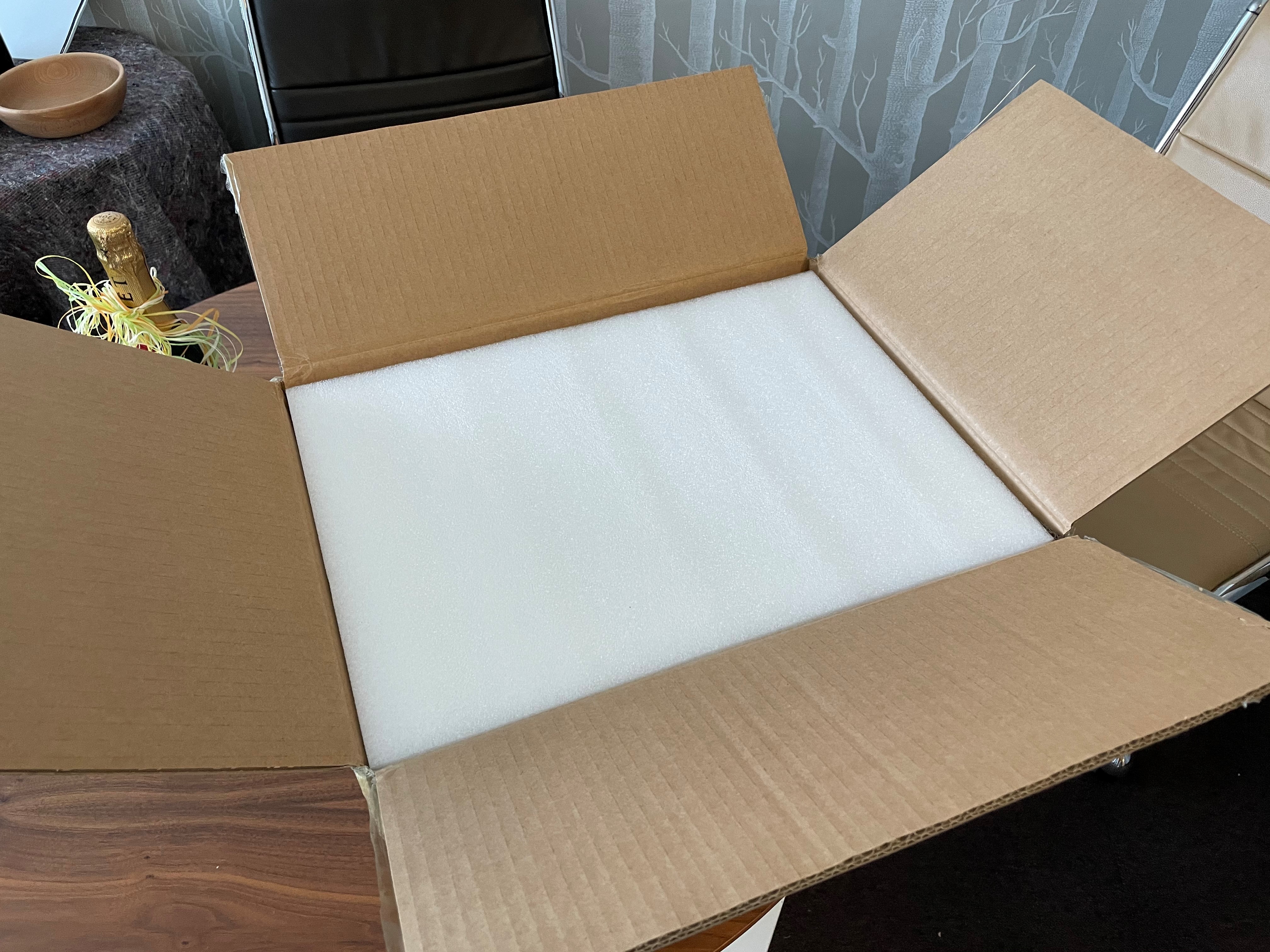

The VR-3 has been delivered and I took a couple of quick shots to show the unboxing.
I also quickly put on the HMD which is quite hefty (just look at that heatsink!) and the headstrap felt incredibly comfortable; I particularly appreciate the top strap, it lifts the HMD beautifully and provides a pretty good balance to the whole setup.
I do hope I’ll get the time to install the HMD over the weekend and will report my findings.

Awesome!! Really looking forward to your first impressions
from the pictures it looks like it has a extreme depth that might result in some lever force when wearing it and might also impact inertia when moving the head
also - champagne with the headset? seems you really enjoying your new tool
Yes, the HMD is ,chunky‘ but the way Varjo designed the headstrap is unusual and forces you to really have your cranium straddled. This together with the top strap which basically lowers and lifts the lens position while providing lateral stability akin to the studioformcreative strap is a very comfortable and stable solution.

And the Champagne is for an employee of mine who just completed his Master summa cum laude :wink:

Good choice, you cannot go wrong with Moët Brut and a pile of Milka sweets! :wink:
