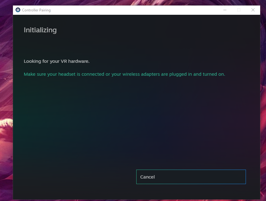

It seems to definitely be a steamVR issue. Pimax needs to upgrade their software to match the new steamVR update or allow more controllers to be used at once in the Pitool software. That is the only way I can see this issue fixed. Tried everything, doesn’t work. The issue is getting the full body trackers from Vive to work with the newest SteamVR. Pimax headset works fine with the new SteamVR. It’s just only allowing 2 controllers in Pitool and SteamVR apparently refuses to recognize my Vive Trackers unless they are connected to an HTC Vive, or Valve Index even though they were working flawlessly before.
I’m not using steamVR beta branch, what happen when you try to “bind new controller” on your computer? mine just say looking for HMD and ask me to make sure my HMD is connected or wireless adapted is plugged in…it won’t let you bind the vive tracker nor any additional controllers
