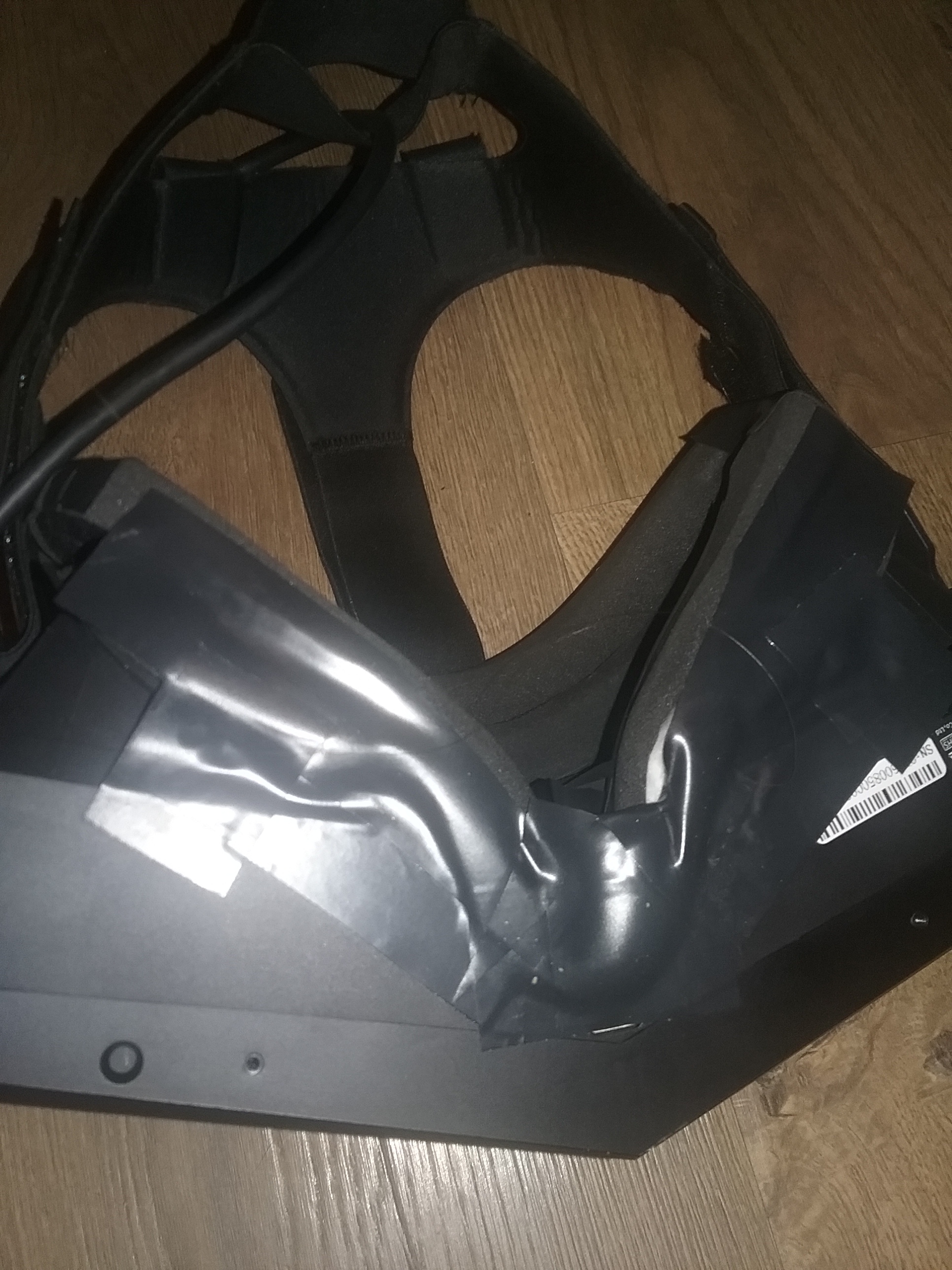

Hi- I use VR COVER pads for VIVE, which suits quite good. And to close area under nose, I did cut partially original foam from pimax foam for this section only. Looks goos and feels good. And does not smell that much any longer, too.

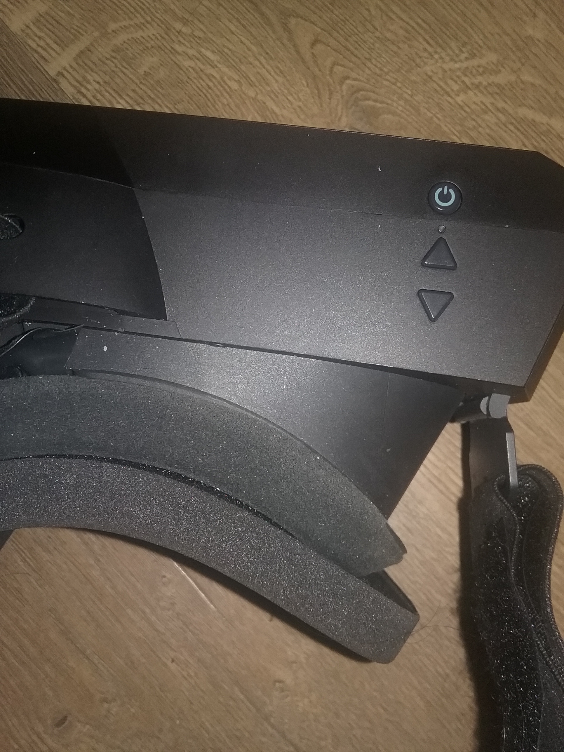

My solution
Pimax foam on top of vive wide foam
Placed self adhesive Velcro between to keep them from moving.
Works well for me.
Nice! Foam-ception. I like it. If I had a spare laying around, I’d try it.
Does the cover go over the existing foam? The picture makes it look like it replaces the existing foam and it actually looks to be about the same thickness; maybe thinner.
Yes, it does replace the original one and is slightly thicker. But your are right. It might be still not enough. I will check, if I can use an additional small foam layer to make it thicker.
Okay, so I actually took the foam off my Vive and put it over the top and it works pretty well. Obviously it doesn’t stay on, but works until I find a more permanent solution. Thanks for the suggestion!
If you put the vive foam first the nose area of the pimax foam will hold the bottom of the foams in place. Then the only problem will be the top. I also added tape to it now if you have it you could do that.

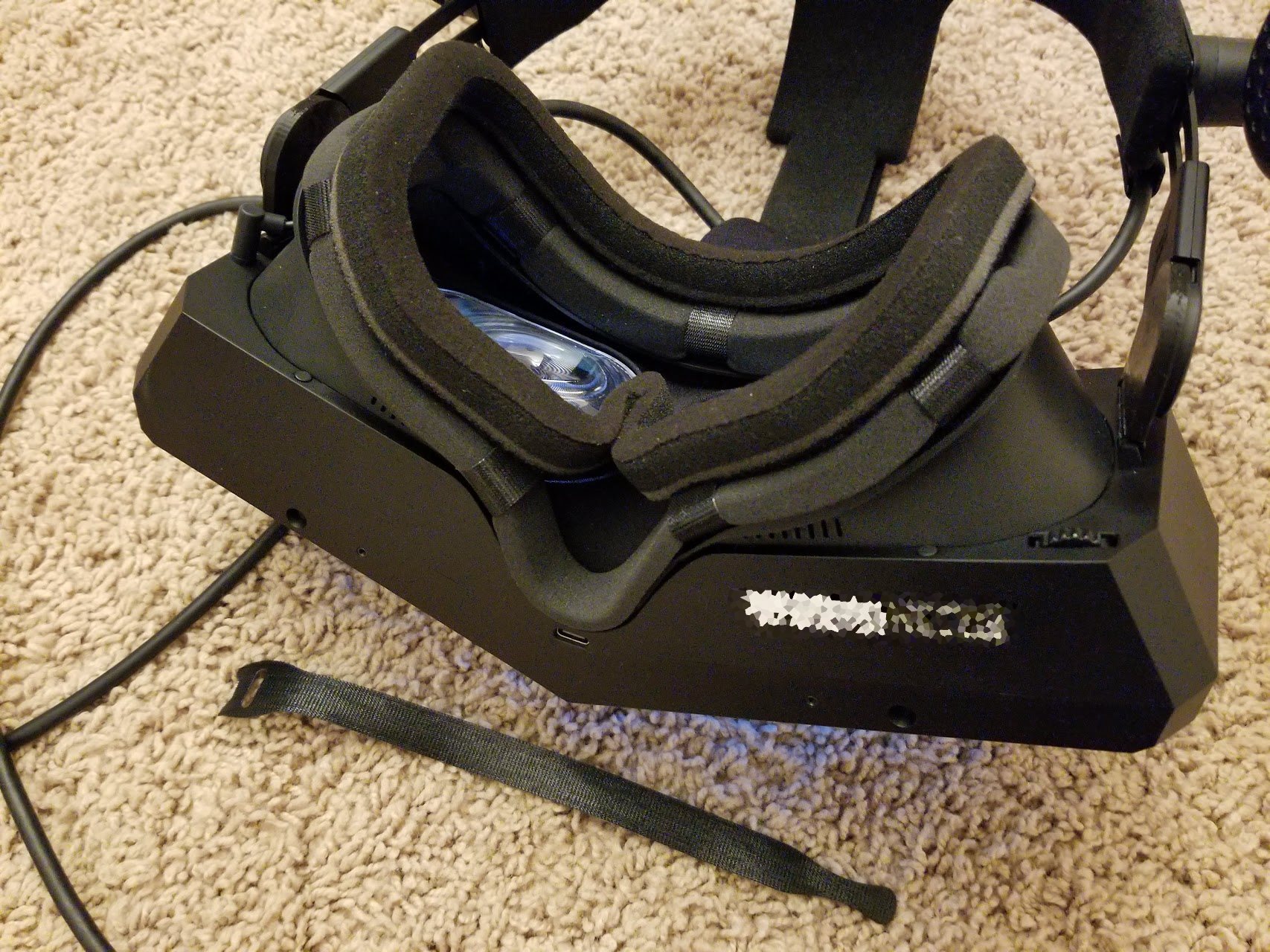

I ended up using the foam from my Lenovo WMR headset. I had some velcro and wrapped it around the pimax foam in various places, put it back on the headset and then stuck attached the other foam on top. I haven’t tried it out for any long sessions yet; only a quick fit check to make sure my glasses would fit and it would fall off. It it not as secure as it could be, but there is zero light bleed thanks to how the nose piece bends up on the Lenovo foam and it seem secure enough to not have to worry about. I cut the velcro to size so it wasn’t excessively wrapped around the pimax foam.
