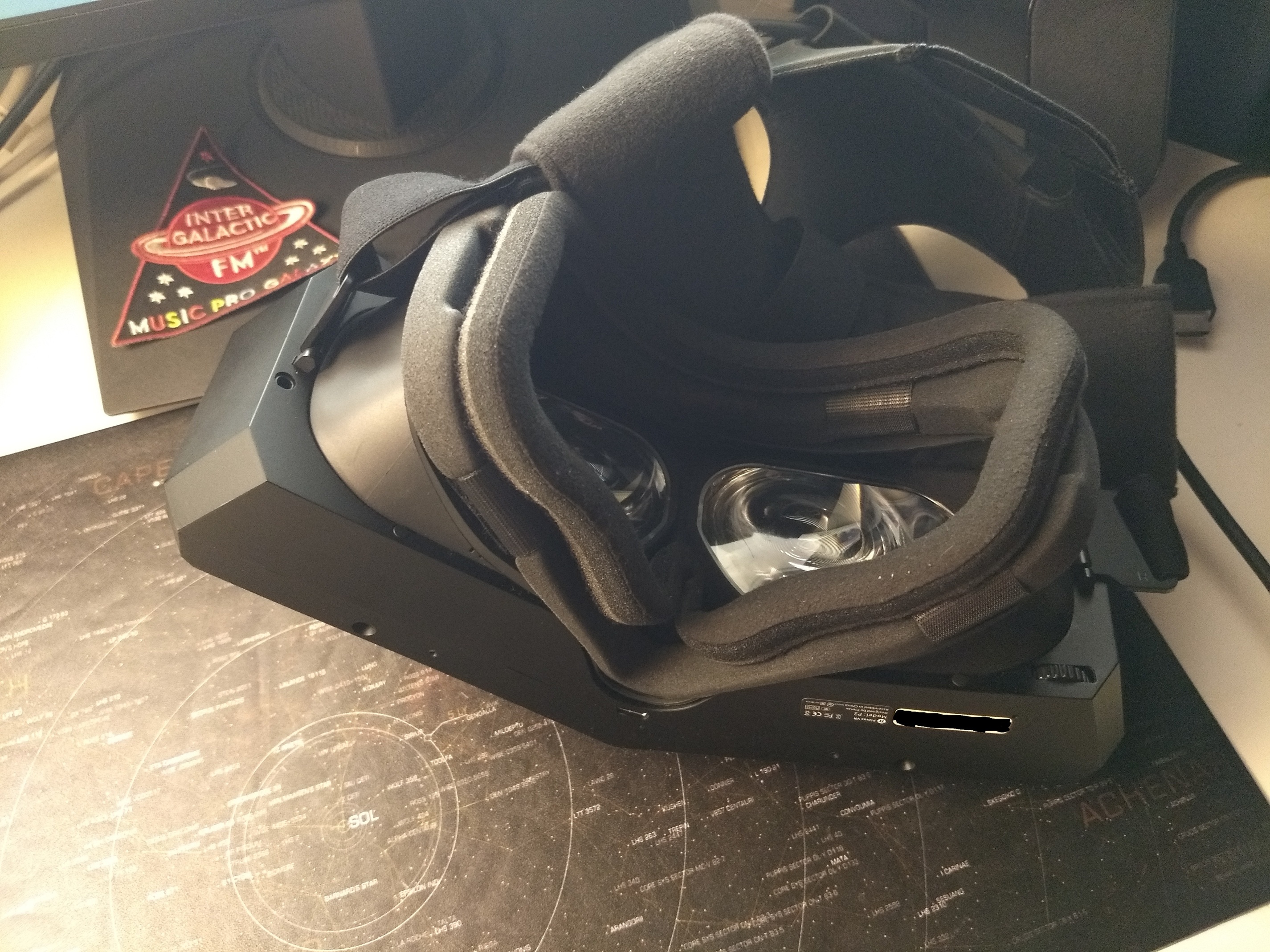

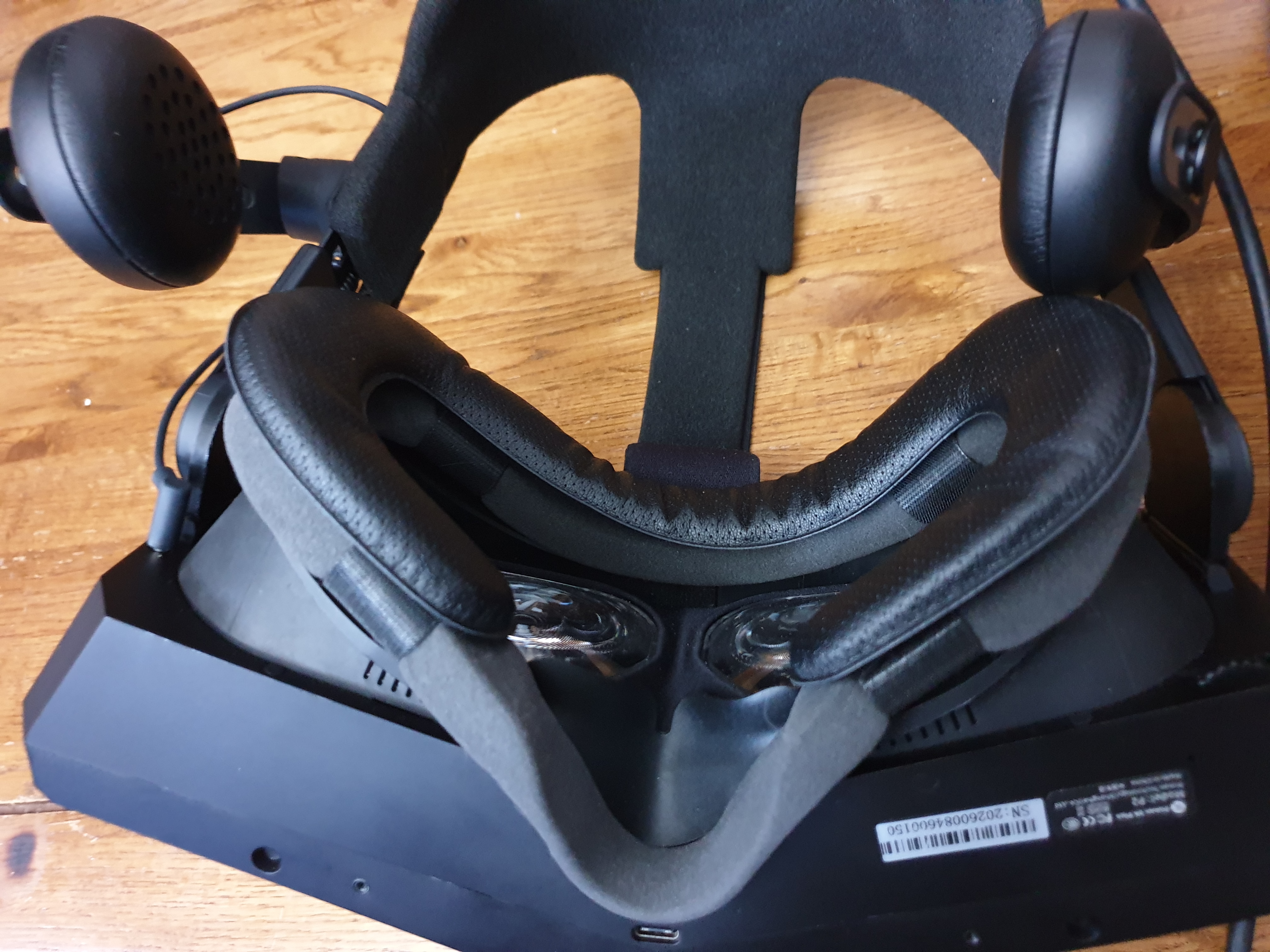

I had a roll of double sided velcro & attached a kiwi design 6mm pad on top of my 11.5mm pimax one.
It’s just about right for me now.
Oddly The 11.5mm + 6mm on top, feels better than a kiwi design 18mm on it’s own & just about keeps the lens off my nose as long as I dont tighten too much.
11.5mm pimax + 18mm was too much & affected outer distortion.
Come on pimax. Sort it out & include a thicker one.
We shouldnt have to bodge face cushions to make the headsets useable.
I was fighting with the cushion height for weeks so as to let my glasses fit in without hurting my nose…ending with contact lenses as the only solition.

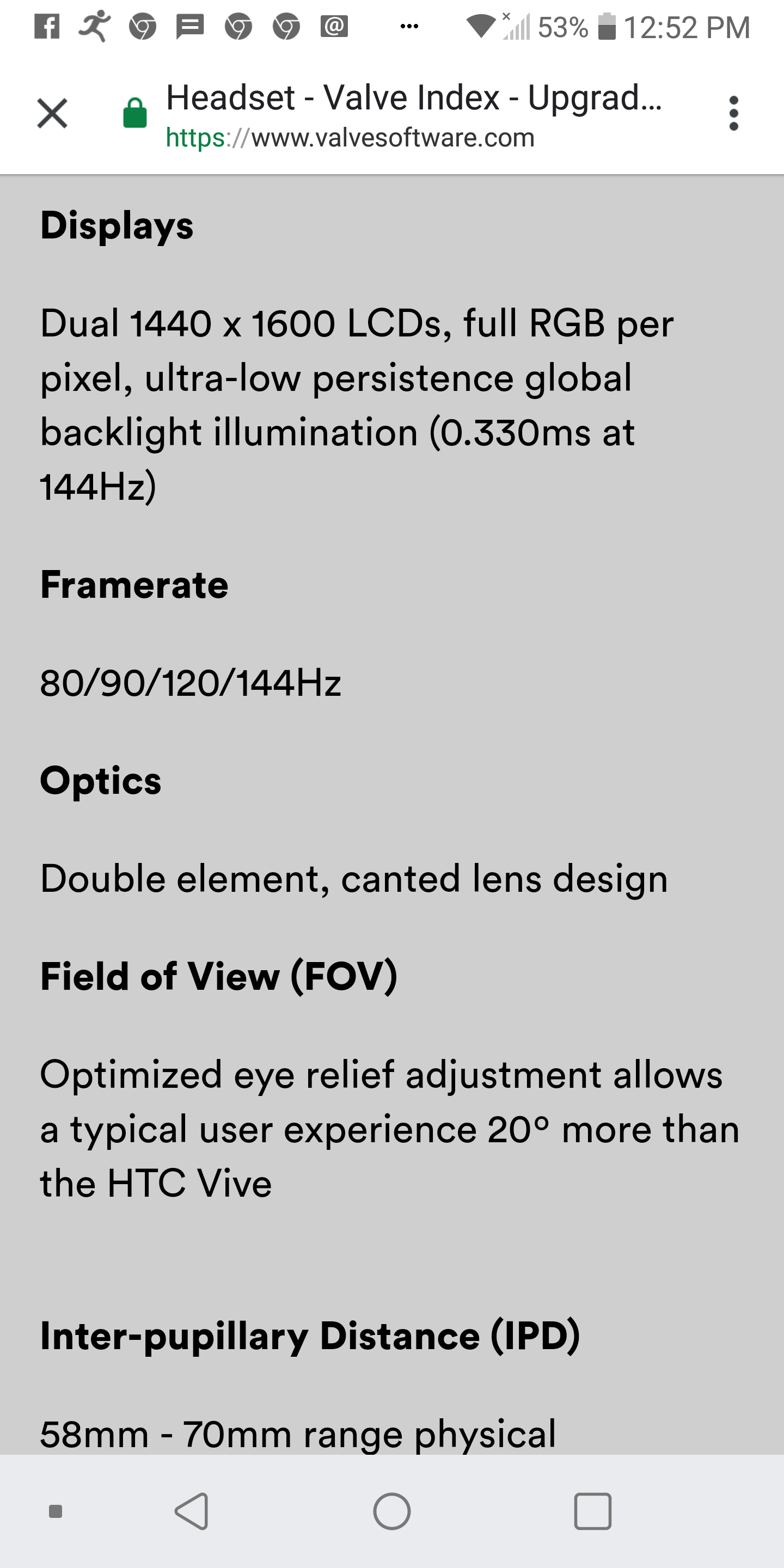

https://www-pcgamer-com.cdn.ampproject.org/v/s/www.pcgamer.com/amp/valve-index-specs-price-pre-order/?amp_js_v=a2&amp_gsa=1&usqp=mq331AQCCAE%3D#referrer=https%3A%2F%2Fwww.google.com&amp_tf=From%20%251%24s&ampshare=https%3A%2F%2Fwww.pcgamer.com%2Fvalve-index-specs-price-pre-order%2F
“Optical Canting”
“Instead of a mount perpendicular to the user’s eyes, the headset’s displays cant outward by 5 degrees. This improves outer FOV while balancing the inner FOV.”
Yes they contradict themselves. If optics & displays are canted than optics are parallel to displays. Making distance to screen even.
So not the same as pimax setup as only displays are canted.

Yeah even looking at the pictures on the HMD web site they displays do not look canted at all so its probably just the lenses
Keep in mind 5° is still very slight. Often specs are not well published as we’ve seen.
