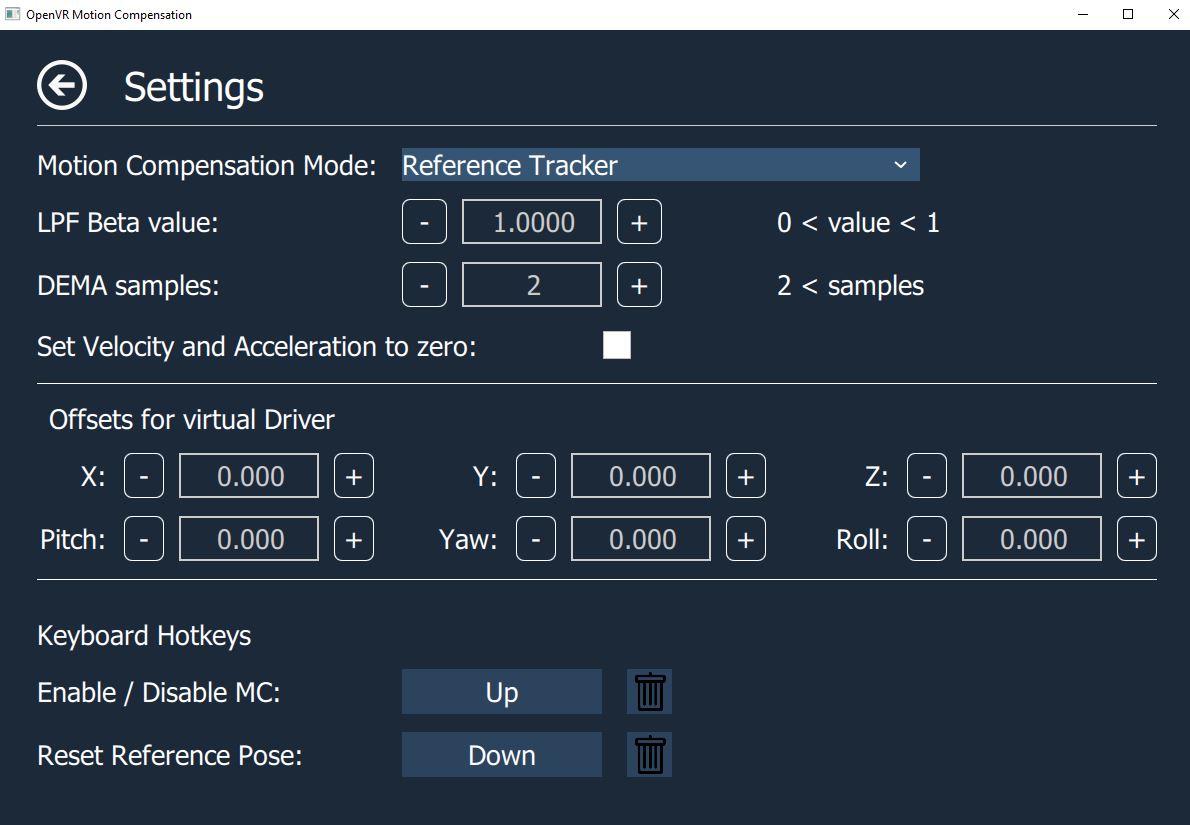

EDIT: do make sure to set the two compensating values within OVRMC settings as little as possible in the beginning. I found that the stock smoothing was too slow for my taste and caused nausea.
EDIT 2: These are the settings I use.
