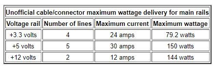

I don’t think he understands your question. That being said, USB ports on the motherbaord are fed by the 24 pin connector which should be 5V at 30 amps. It could be that the PSU has a whole bunch of other components on the other rails or is a lower end spec with poor power output filtering (pretty common on pre-built computers as this is where integrators save money).

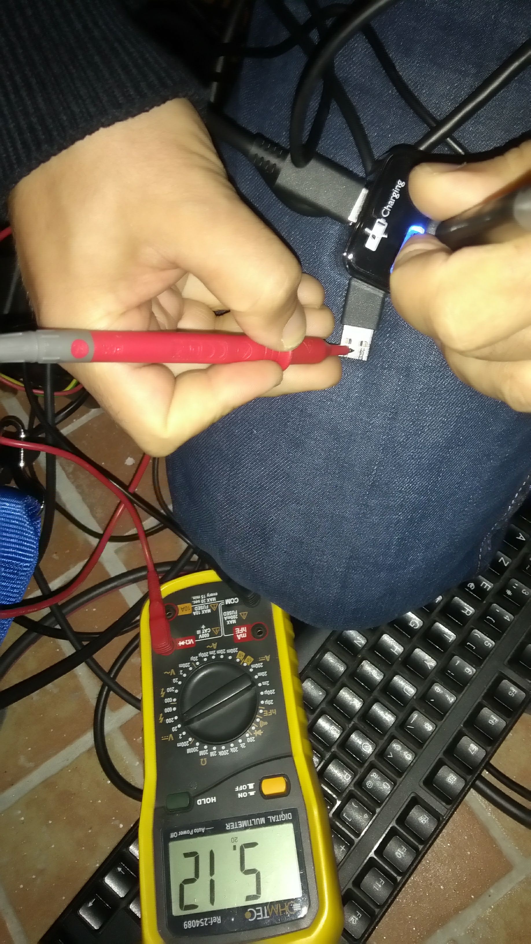

@Heliosurge and @Soarin, I plugged the Pimax on an externaly powered usb hub, same result. So it doesn’t come from my computer. And my computer has a bequite Dark Pro 11 750W power supply that should easily do the job…
Other than testing with a voltmeter to check for a short on the USB cable or the headset there is not a lot more you can do. Do you happen to have one?
Okay so you seeing 0.12 volt excess being supplied on one or both USB headers from your AC mains. I have no idea what the tolerances are for the 8KX, I would not expect 0.24 volts to exceed the power limits. This only confirms that your power supply is okay, now yank the DP cable out from the HMD and measure the resistance from the power rail of the DP cable to each of the USB headers.
You want to be measuring from pin 20.
Need an amp meter. However I do suspect the headset is defective imho.
We could always hope it is a bad cable, that is a bit easier to remedy.
Guys, it isn’t 5v between vcc and ground, it’s 5v between shield and ground ! It should be 0V
Oh damn you are right, I mistakenly though the VCC was via the shield

Umm… That should be 3.0 amps. 30 amps would flip a circuit breaker in most households. Never mind. :slight_smile:
Not if it’s 5V… :wink: That’s only 150W (5x30).
That said, I really don’t think the 24 pin ATX connector supplies 30 amps in 5V… :slight_smile:
EDIT: It actually does:
I did do a quick look up first and the power supply I found only had 5V @ 3A, but you’re right. There are plenty of PC power supplies which provide a lot more than that.
