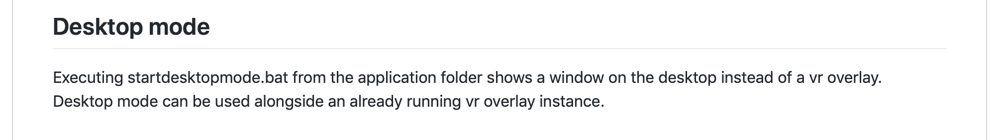

How to open openvr advanced settings without controllers?
Do you mean the slider in video or in application ?
Go to settings in steamvr, video, check manual override and use the slider there
Are you talking about the slider in steamvr settings or openvr advanced settings?
I was doing this in The Lab with Cindercone, a rocky photographic area. I got a great clarity boost up to 250% in SteamVR but after that I noticed no increase in quality.
Now gonna try some more
Steam Vr, can’t access open Vr advanced setting without controller .
edit apparently i can :slight_smile:
Oh, I think it’s in video, then you check manual override and change that slider. Will get back to you in 1-2 hours to make sure
