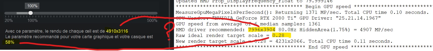

i would like to know if you got the same weird recommendation as me (I have a pimax 8K with large FOV).
For a render quality set to 1 in Pitool (beta 121_R211), i can’t believe Steam vr is recommending only 58% with an RTX2080Ti and the latest drivers (nVidia 419.67).
Is that normal ?

Could you check your vrcompositor.txt log file and post the GPU speed section? It should look like this:
****************************************** Begin GPU speed ******************************************
MeasureGpuMegaPixelsPerSecond(): Returning 875 MP/sec. Total CPU time 0.10 seconds.
GPU Vendor: "NVIDIA GeForce GTX 1080 Ti" GPU Driver: "25.21.14.1771"
GPU speed from average of 6 median samples: 882
HMD driver recommended: 3202x2633 90.0Hz HiddenArea(8.73%) = 1385 MP/sec
Raw ideal render target scale = 0.64
New render target scale = 0.64 = 2562x2106. Total CPU time 0.10 seconds.
******************************************* End GPU speed *******************************************

Sure. Here it is:
MeasureGpuMegaPixelsPerSecond(): Returning 1371 MP/sec. Total CPU time 0.10 seconds.
GPU Vendor: "NVIDIA GeForce RTX 2080 Ti" GPU Driver: "25.21.14.1967"
GPU speed from average of 6 median samples: 1361
HMD driver recommended: 7996x3904 80.0Hz HiddenArea(1.75%) = 4907 MP/sec
Raw ideal render target scale = 0.28
New render target scale = 0.28 = 4231x2066. Total CPU time 0.11 seconds.
I guess you have parallel projection on. I had it off. Just pointing out that we all forgot to mention that parallel projection option also have an impact on the final resolution.
