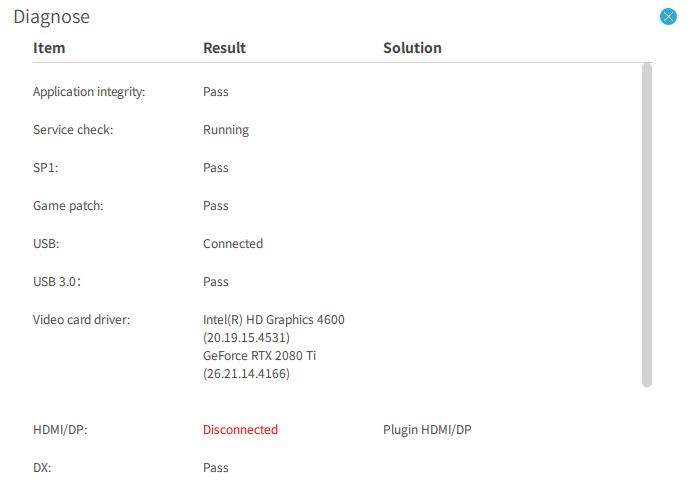

Can you try the help tab in Pitool & select Diagnose. Please post Screen shot.
I would file a support Ticket in case a Teamviewer session is needed.
Hello Heliosurge, thanks for your quick answer, here are the screens :
By the looks of it you may need to disable the Intel HD graphics in the Bios & possibly in Windows Device Manager.
The Intel Integrated Graphics is likely interfering.

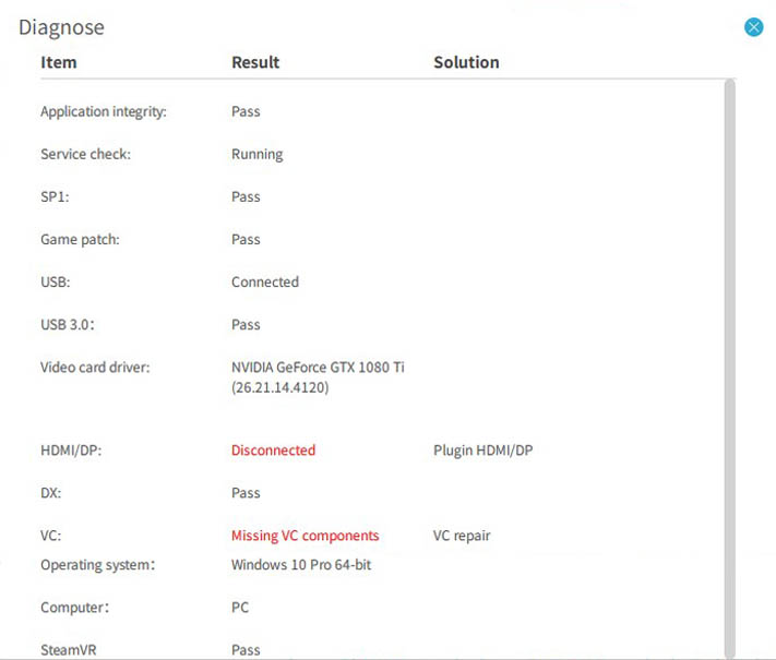

Hi C-Dric and Heliosurge.
I´m in the same problem.
Only diference is GTX 1080Ti
and
VC: Missing VC components.
Thanks in advance.
Tino
Hi Tino,
You will need to install Visual C redistrubute.
Should come with Pitool & often comes with a variety of games.
Will see if can find a stand alone link.
https://www-techspot-com.cdn.ampproject.org/v/s/www.techspot.com/amp/downloads/6776-visual-c-redistributable-package.html?amp_js_v=a2&amp_gsa=1&usqp=mq331AQCKAE%3D#aoh=15774936096311&referrer=https%3A%2F%2Fwww.google.com&amp_tf=From%20%251%24s&ampshare=https%3A%2F%2Fwww.techspot.com%2Fdownloads%2F6776-visual-c-redistributable-package.html
