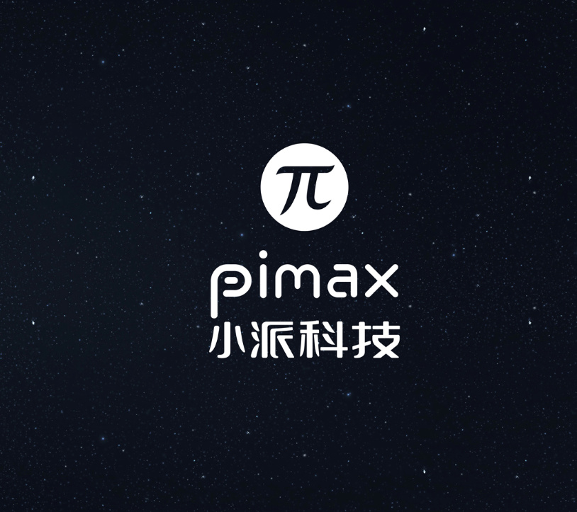

I had a play last night and noticed in dark scenes that I can see the pimax logo appear to be residual on the screen!!
The logo is what you see when you don’t have anything running and have pimax VR home unchecked (usually due to it heavily using GPU when you’re not even using it!).
I don’t know yet if the effect is temporary or permanent?
But I can confirm the headset has not been turning itself off/going to standby when not in use and so most of the time I’ve manually done it, it’s not through that much use the perceived burn-in has occurred.
For now, I highly recommend for everyone to manually turning off the HMD when not in use.
Pimax. Can you look at this with some urgency, please? A static white logo is clearly a bad idea and the lack of proximity sensor along with whatever the current solution is supposed to be doesn’t work! or at least doesn’t for me so likely will affect others too in time!

Have to search forum here. But it would be temporary as lcd apparently don’t perm burnin.
If you look in your pitool folder there should be a pic of the logo. Just replace it with a blank image.
Hopefully they will give option to use animate gif file (might work)

I can see the logo at the following path:
“C:\Program Files\Pimax\Runtime\resource\pimax_default.jpg”
I’ll replace that thanks! But pimax need to look into all of this.
The standby is working again, although only the image goes off, not the backlight as we know making it harder to know if its in standby or not. I hope they can get standby powering all off properly and they look to improve on that background image to prevent the burn in effect, even if its temporary its going to be visible a lot for many people.

As for heavily using GPU,
PiMax Logo picture just like wallpaper of desktop and only take a slim GPU.
If you can see fire or burning on the screen which means your pimax vr home task still runing and using GPU heavily.You can shutdown the pimax vr home and this problem solved

Yes the GPU usage is what I was referring to for home (which ideally you should get to pause when no activity detected!), hence some of us already disable that and use the static wallpaper (bright white pimax logo on dark background). However that wallpaper is causing burn in! which even if temporary its happening and noticeable.
Too bad Pimax didn’t think to add a proximity sensor like most of the other VR headset manufacturers did. That would have eliminated this issue entirely.
I agree to a point. If they ensure the gyro sensor works well then fine no need for the proximity sensor. I actually think they need to change the pimax logo screen though, its the worst static image to have!
At least I know we can do this ourselves now, but I’m still suggesting they look at doing this by default.
