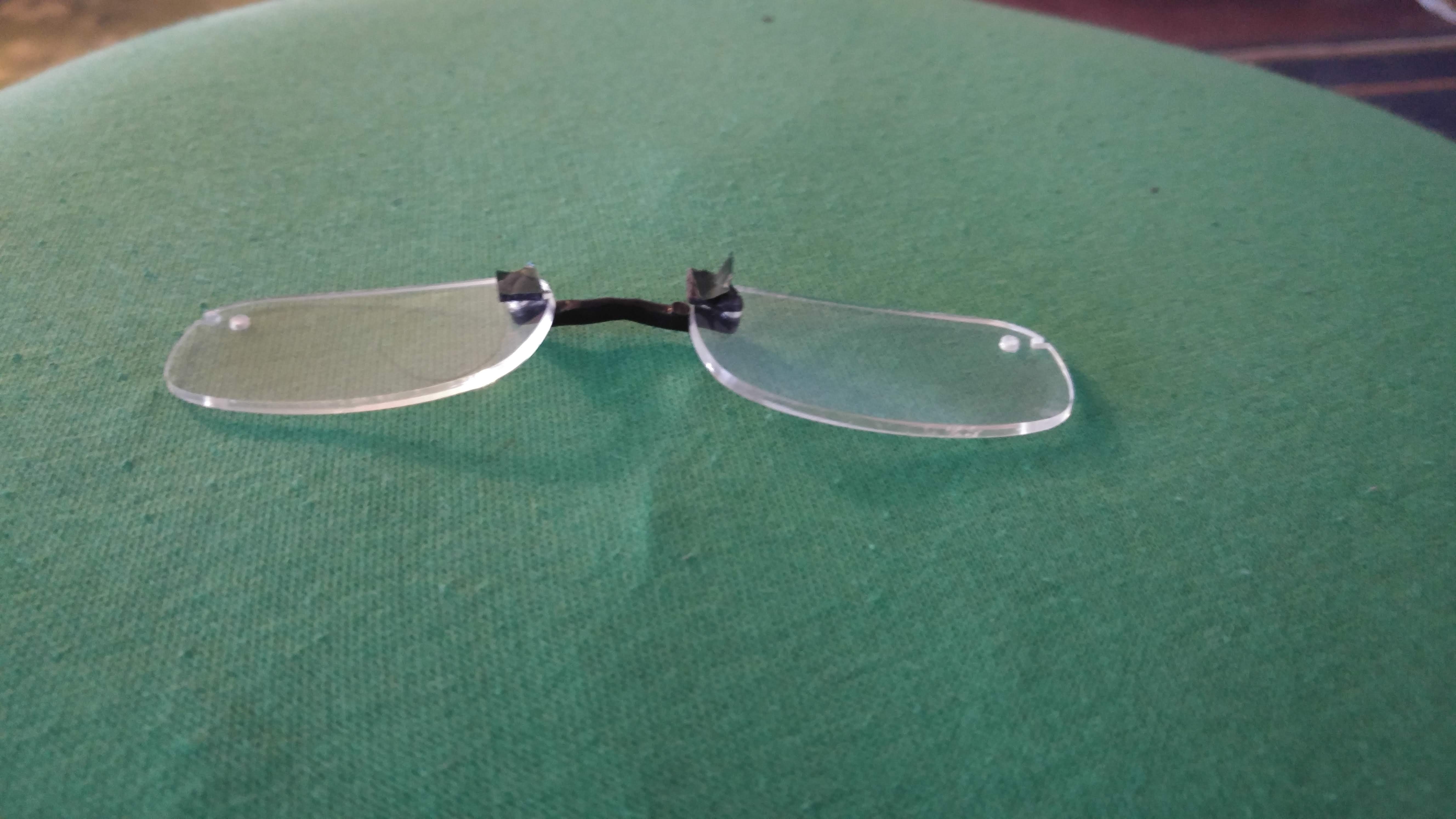

maybe you could try this method that I use for my reading lens ,
I removed the arms from a rimless pair of glasses , turned them round so that the concave was towards the pimax lens , and bent the bridge out slightly to match the cantor of the pimax.
some slithers of slightly rolled double sided tape hold them firmly in place.
You can hardly notice the tape when wearing the headset
The effect is like a large clear focused area covering about 80% of the view only a bit at the top and bottom are still blurry like very good ffr .
works well for reading glasses
