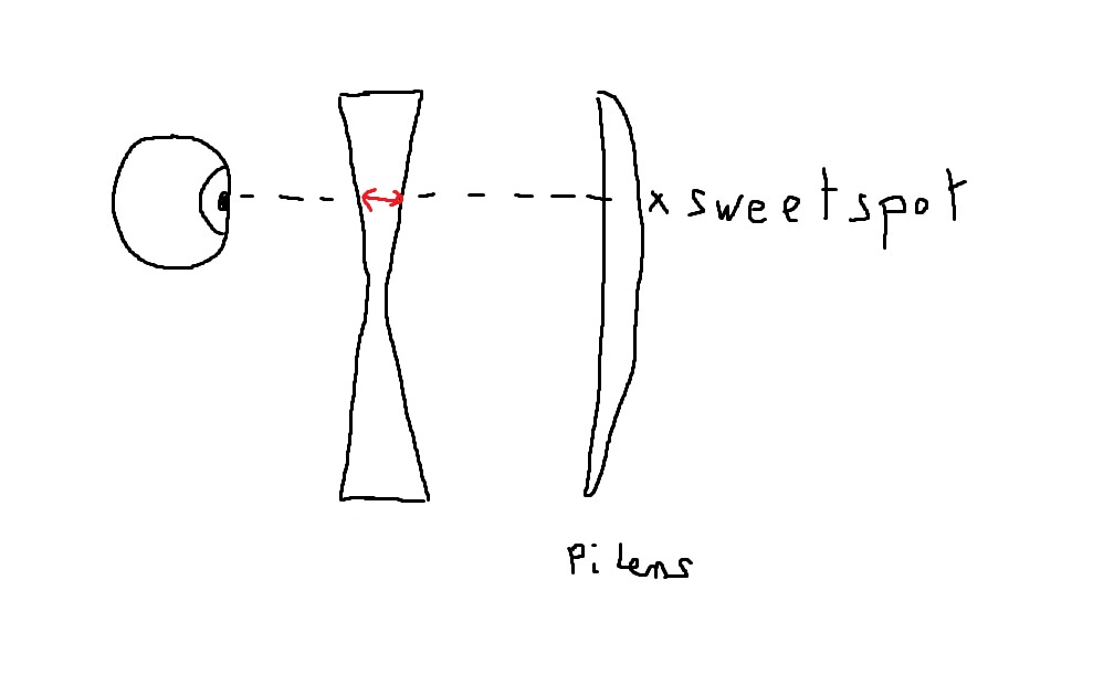

Unfortunately not. Classic prescription lenses are symmetrical, pupils are supposed to be in the middle.
Unlike other headsets, Pimax lenses are asymmetric: sweetspot and pupils are 1/3 inner side. Even if you remove them and give them to any optitian (and risk to badly scratch them), I doubt any optitian can make them. Not because of dimentions but because of concavity. Most of optician aren’t formed to make this kind of custom lenses and any error will cause distortion, blur or so :wink:

Lenses are concave or convex, depending on your vision disorder, and made to be centered on your eye. If you put classic lenses in the Pimax adpater, your eye will be over a thickness that won’t fit to correct your vision AND peripheral vision will also be affected.
I made a top view schema, you’ll se that’s easy to understand.
Symmetrical lenses:
Asymmetrical lenses:
It’s mathematical! Anyone without optical knowledge can understand :wink:
Thanks for view schema. I have very good optician in my town , I think it will be no problem for them if I show them where I need lens sweetspot ( focus point) They already did for me many custom inserts for sun glasses and scuba mask. And they never asked more than 50~70$ Thats in my country we are cheap & slave but with qualified services.
Thats why all opticians measure your IPD when fitting glasses, all glasses are like this. Yes, with my IPD and my glasses the centre point of the lens is roughly one third in from where my nose is. They cut the lenses to fit YOU, your IPD and the exact frames you’ve selected.
All glasses are like this, the pimax adapter is absolutely no different from a regular pair of glasses, just no arms and it clips in to the headset.
What you are describing is exactly how all prescription lenses need to be fitted to each person.
