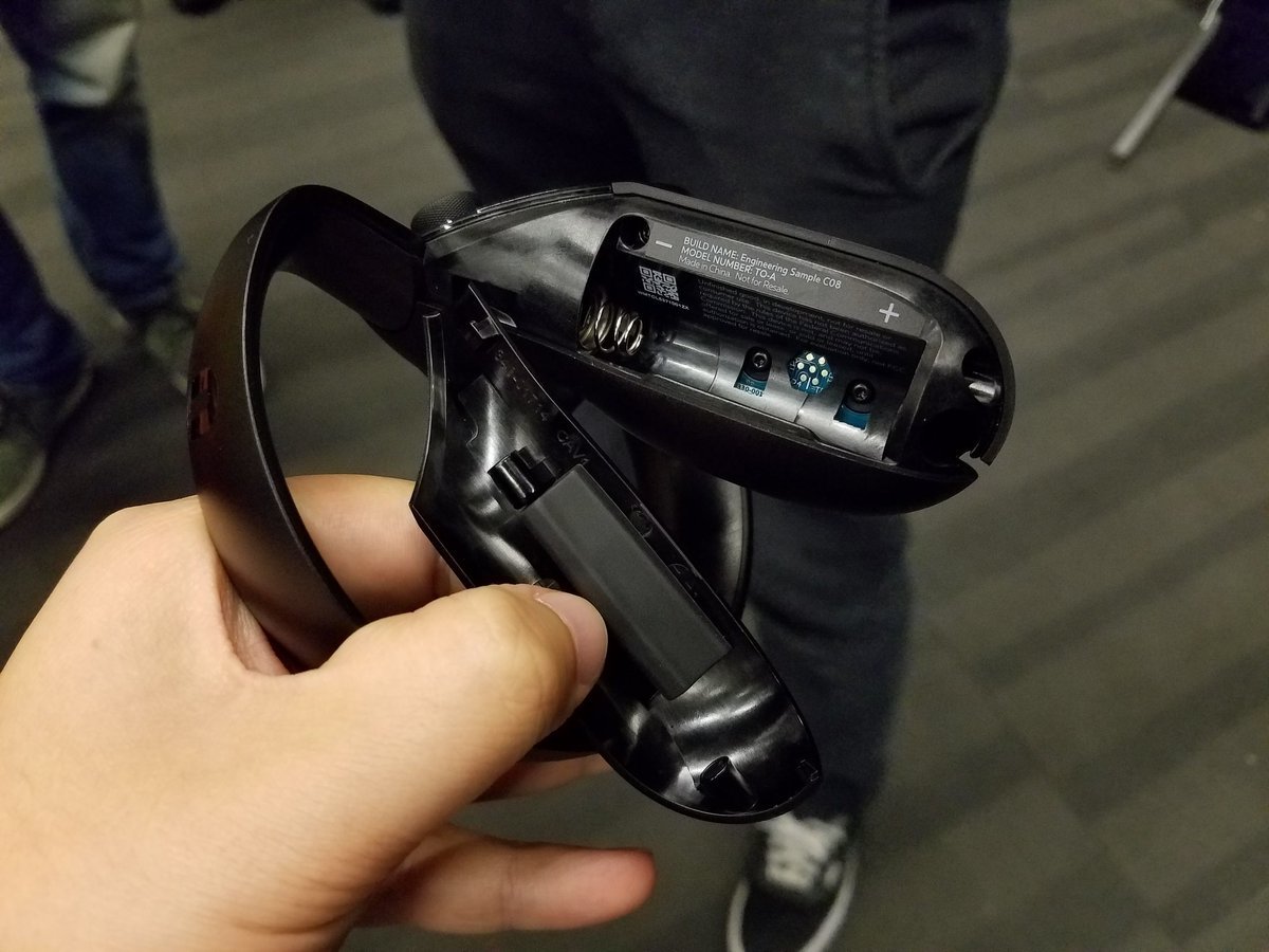

I propose to get away from the built-in rechargeable batteries, which have few hours of operation, and this is very small, compared to capacious AA-type external batteries.
For example:
  • in Oculus-touch the cheapest alkaline batteries were enough for 12-14 days of daily work for 3-4 hours a day.
  • In controllers HTC-Vive built-in batteries work only 6-7 hours on one charge, and after that they have to charge for 2 more hours. And, in time they will lose their capacity.
This is an unacceptable time to work in my opinion, not optimal
In the oculus-touch it was possible to forget that about charging for controllers for 1.5 - 2 weeks.

I really liked the locking mechanism on the oculus-touch, where you insert one AA battery, and the lid on the magnet itself came into the controller.
