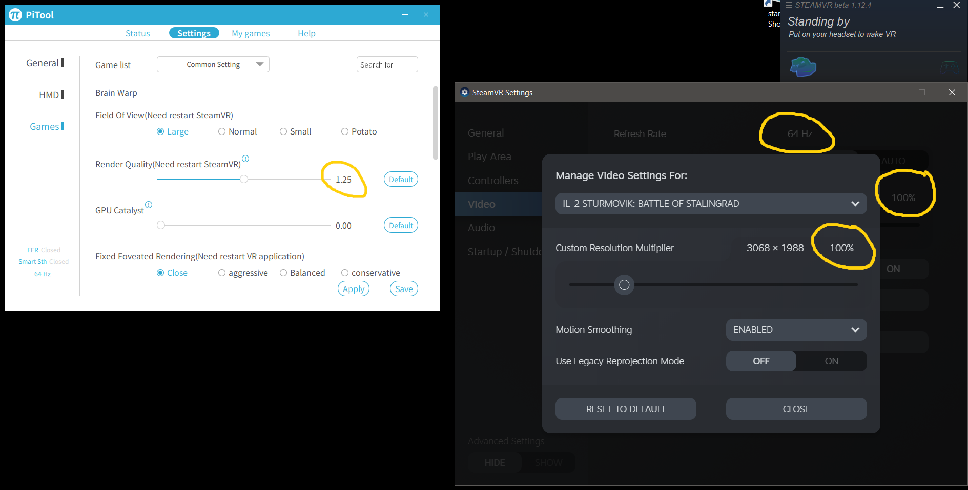

Settings I used to use in SteamVR are now needing to be doubled. Previously I would use PiTool 1.25 on Large FOV and 64Hz with SteamVR Video 50% and App 50%. Now the same setting is achieved with SteamVR Video 100% and App 100%.
I do seem to notice better image quality at same render target resolution. Meanwhile StemaVR Auto is telling me 136% but not so good for me spotting things in Il2.
