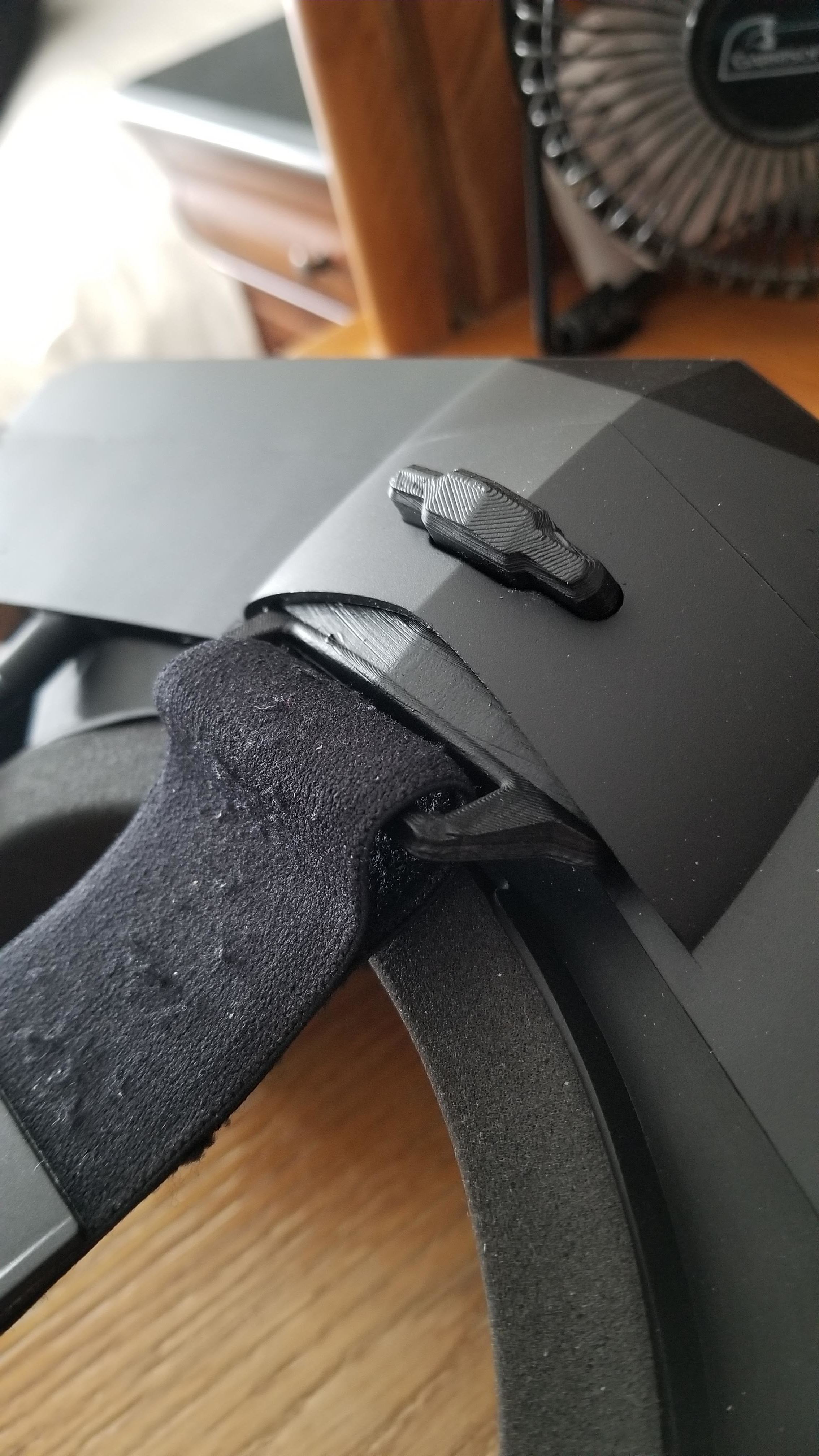

After filing down, getting my thumb cut and bloodied, numb fingers, finally managed to get it done.
I was thinking of doing an adjustable height(Reddit suggestion) ‘slider’ for the DAS peg section that would be a separate piece from the part that slides over the stock clip. I scraped the idea(for now), in order to get a lot of adjustable ‘steps’ it weakened the ‘bite point’.
I see what you are proposing here, however the two pegs overlap one another. It could be done, however the pegs would need to cut into each other.
Should be doable with the support for the peg in between, meaning the inner part, and a bigger opening on the outer part to allow clearance for the DAS peg to go through.

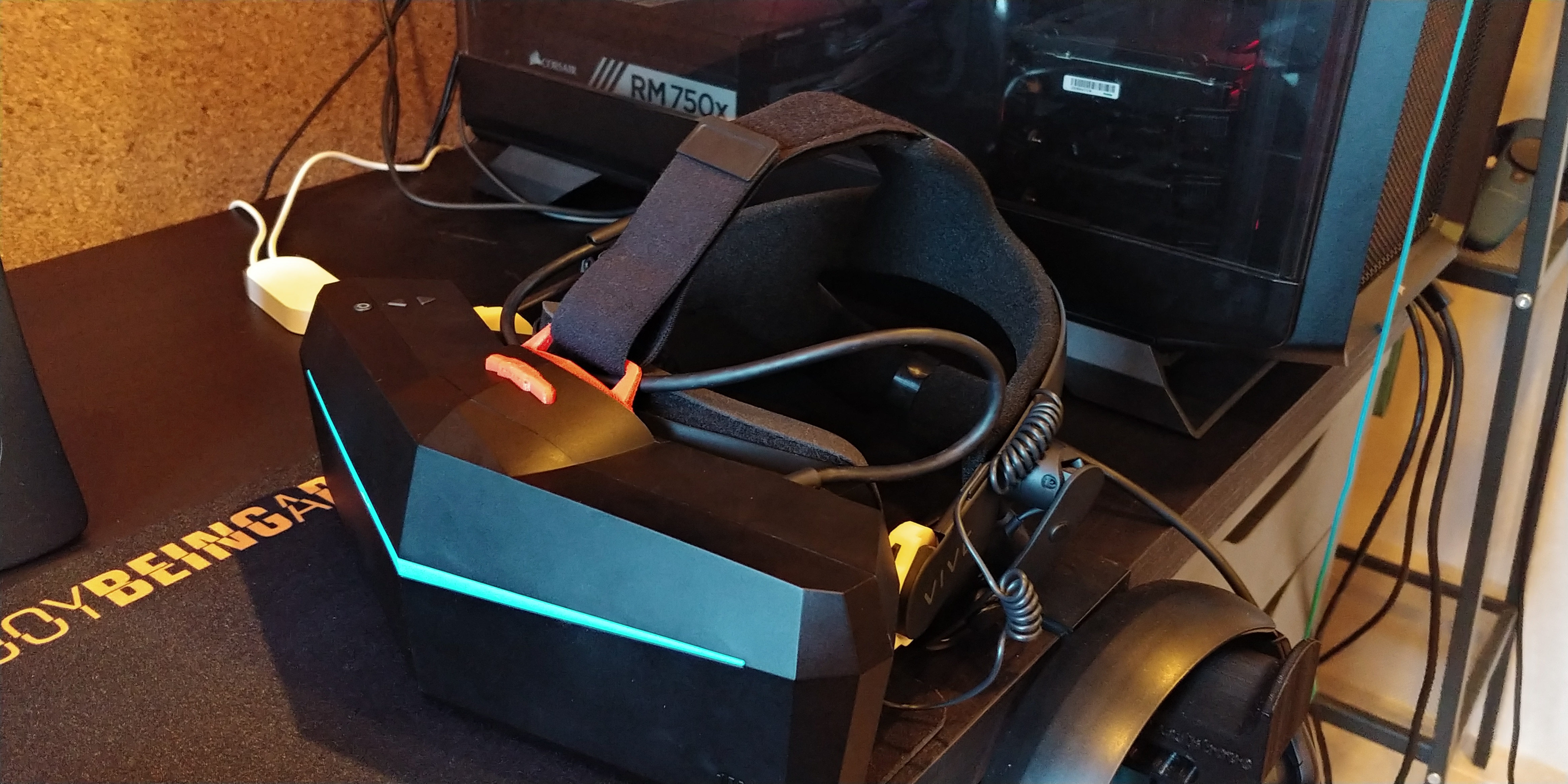

My vive DAS turned up yesterday then I spent 4 hours trying to print the adapters because I couldn’t find the glue stick and they kept moving before the printing finished . I found pulling the face mask off VERY difficult and I had to pull a lot harder than I expected . Once the DAS is all set up it is far more comfortable than the Pimax head strap + it keeps the 5k+ off my nose so I am very happy I decided to buy it .

The 4 v3 files are the new design, I’ve been using these for a couple weeks. I printed at 90% as I’ve heard printing at 100% can create ‘overflow’ due to variations in filament thickness. Any of the DAS designs will never be 100% unbreakable due to the small post needed for the DAS.
Finally grabbed the files from Thingiverse and had a friend print them off. Decided not to sand smooth the parts in order to match the rough finish of our high end HMD lol.
Ok so the 4 V3 parts you mentioned are for the side mounts correct?, what about the upper center mount as pictured below?
I didn’t modify this part, I didn’t feel it need it. I guess I could/should link this part for people who are printing a full set.
Oh ok i see, you modified the side pieces only. I guess I could somehow import the one that DrCube designed.
Looks like you slide in design works well @g-coded! Looks awesome judging by jTeller’s picture. Has a very elegant look to it as well. I’m still sporting your older design and it’s working remarkably well. Would definitely change them to this one at some point.

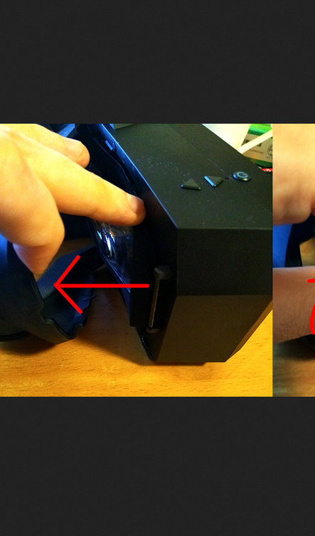

Decided to give DAS a try. Could someone clarify Step 1 of the installation for me? How do I remove that Pimax interface thing from the HMD, just pull on it?
Thank you @Dr.Cube for coming up with the design :slight_smile:
I didn’t remove it, but was able to swap the side hinges without doing so, but be careful so You don’t snap the newly printed hinges when attaching them (I broke one, but had luckily ordered two sets - both the short and the long version of @Dr.Cube’s hinges). Easy does it :wink:
