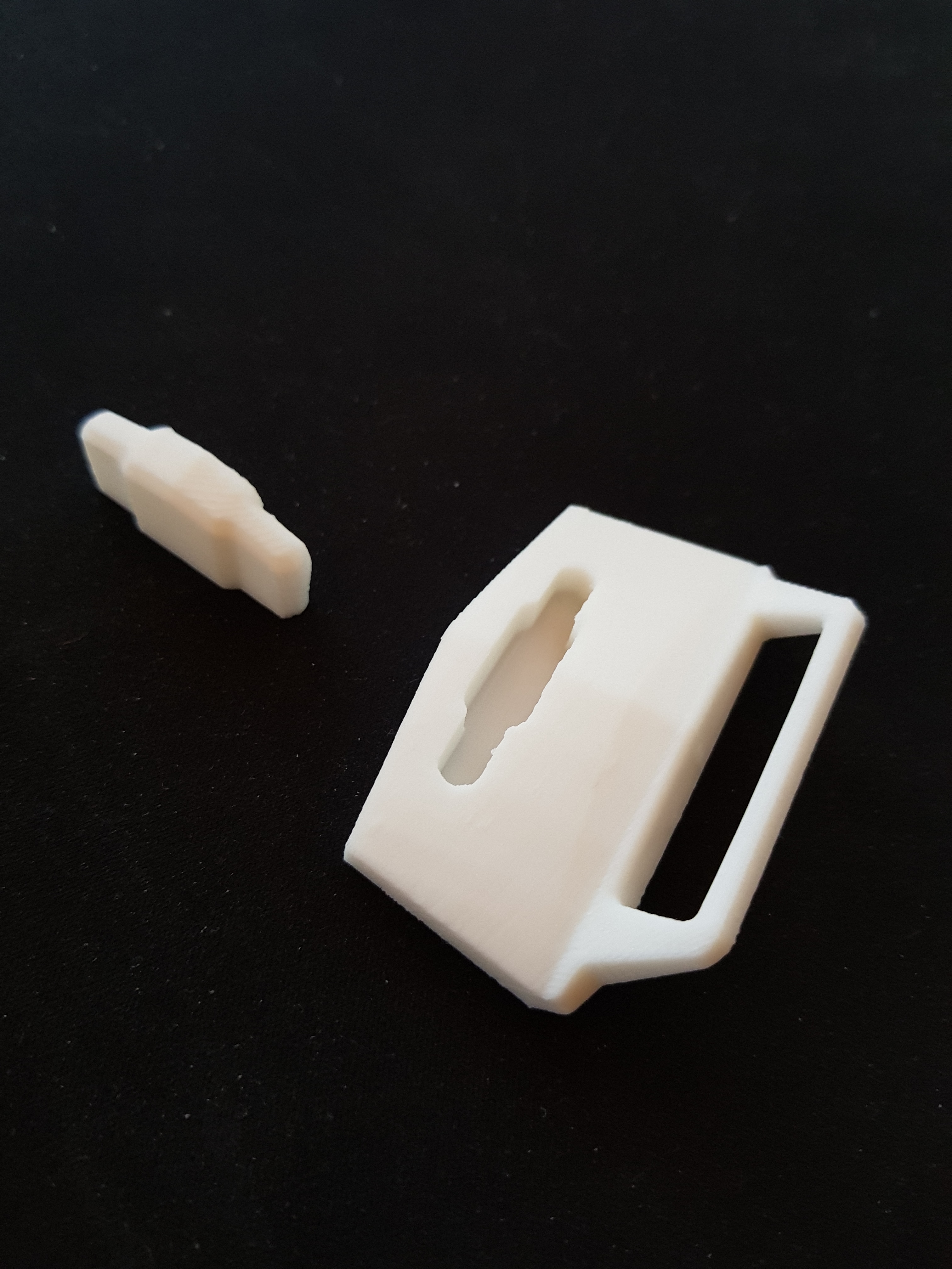

So I printed these today (0.3mm Nozzle, 0.15mm Layer, NGen). The Side Clips are great and snapped straight into my Vive DAS. When I printed the top clip, I used the orientation default in the model, and the clip snapped when I tried to insert it into the 5K+, I have since changed the print orientation to make the layers go across the thin part of the clip; hopefully that will work.
Cheers.
Thanks for testing it. Updated the link with a pegged version.I wanted to make it a secure fit so once you put it in you’ll need to use pliers to get the top peg out. The side on the peg that has a indentation should face away from the front of the headset when put in. let me know if this works better for you.
I’ll still be using the snap in version since I haven’t had any issues with it. It sucks that it’s not fitting for some people and breaking.I tried making the snap in part thicker but it made it impossible to snap the part into the headset. It may depend on what color your printing in. I know some colors are weaker and easier to break than others. The pegged version should be a more reliable solution for most at least.

The pegged version works really well - it fits perfectly and stays secure, great job! Going to reprint it and the side brackets with a better quality material.

Got a new set printed out and some thicker foam for the back (using 20mm version from HTC Vive Deluxe Audio Strap Foam Replacement - VR Cover) so the strap will tighten enough and everything is working great. I would recommend anyone attempting to print the adapter yourself to print the side brackets vertically with a little support material for extra durability on the hinge, as all my attempts to print flat on the bed resulted in the hinge snapping along the layer.

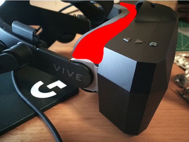

How did you remove the original side bits of the Pimax (with the curvey bits)?
You need to remove the rubber around the lenses 1st.
Holy crap - really? How do I do that? Has Sweviver made a vid?
You just pull at it. It comes out easily and you can just snap it back in.This is the part you pull out: this
Legend bro. I was super-scared of doing it. Sorted now. So much nicer with the DAS

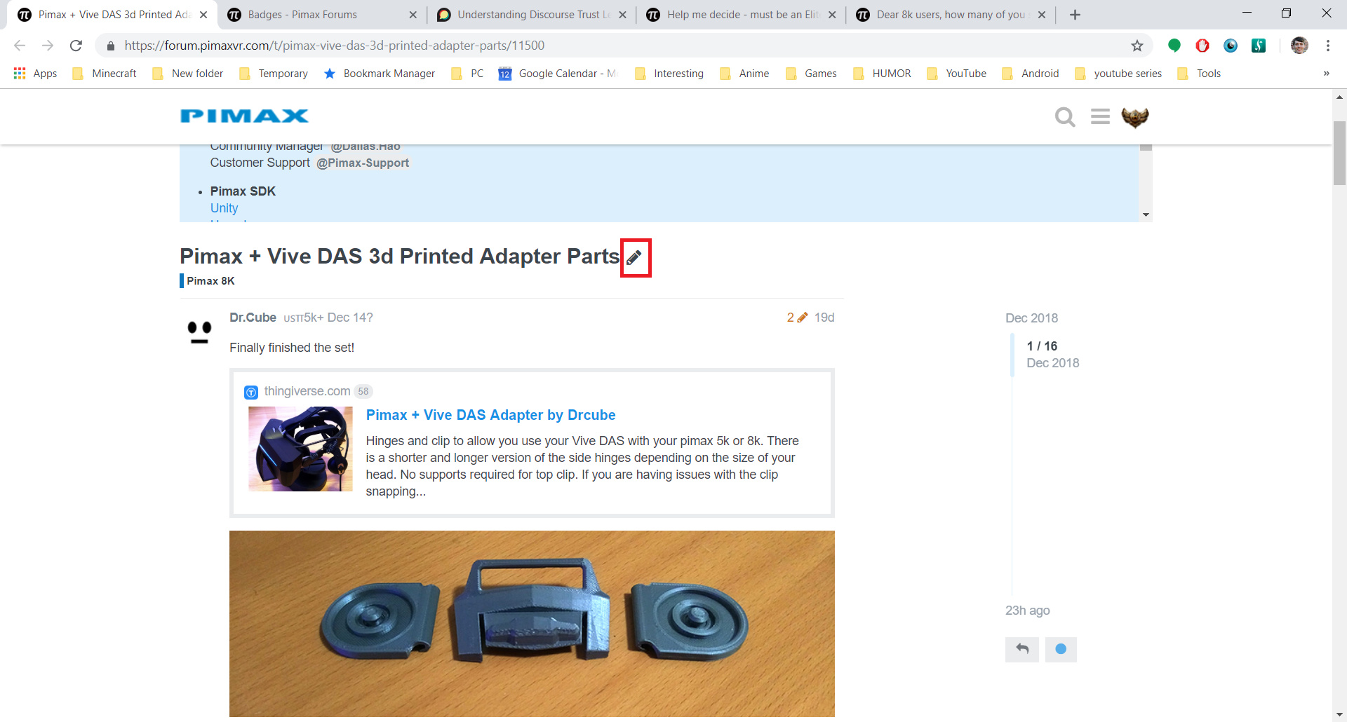

@Heliosurge @Dr.Cube I changed it to VR Accessories/ Gadgets (assuming that is where you meant to put it :wink:). Also, all “Regular” users can recategorize and rename topics (made by ANYONE).
It is a bit of a hassle to get to the user level rules. You have to look at the user-level badges and right-click/open the link (left-clicking will press the badge-button and open the wrong page).

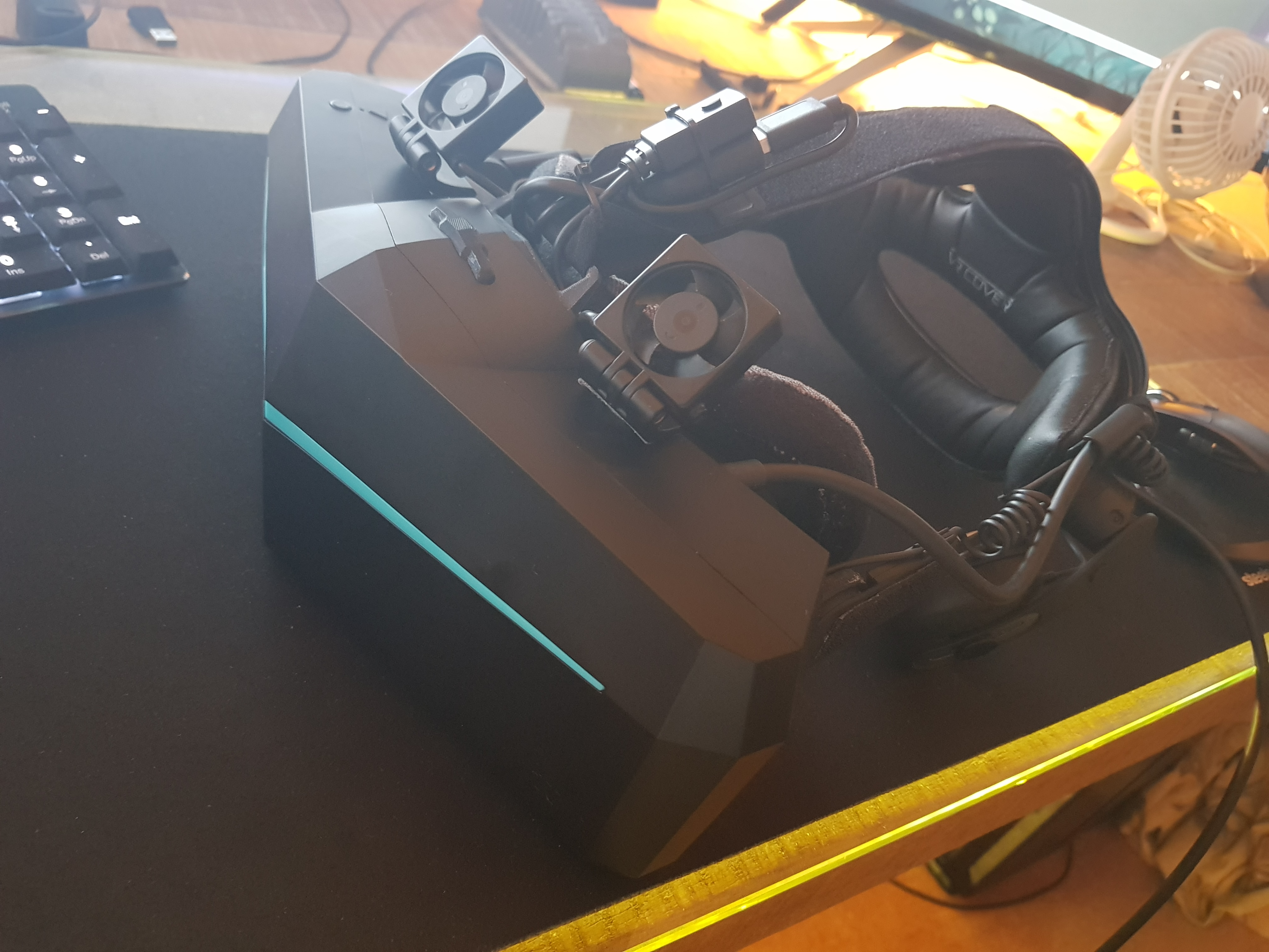

Now to patiently wait for the cooling fans. Darn beat saber xD
